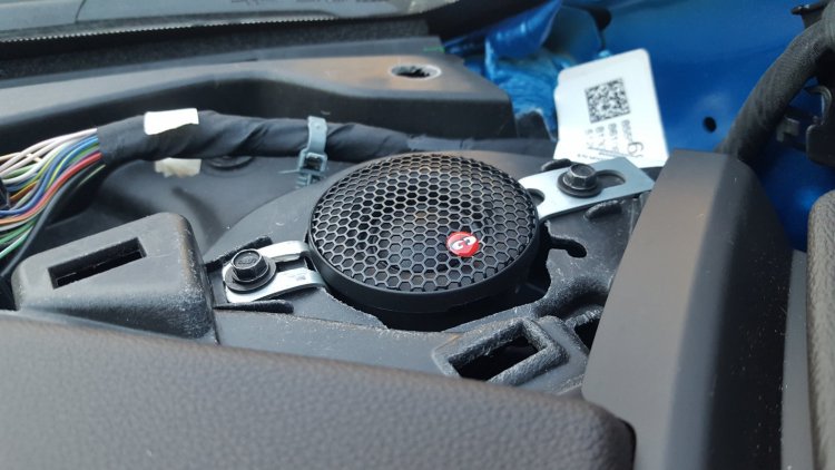

I have a 2022 Silverado z71.  Anyone know how to replace the tweeters in the dash.  Previous models required removing the oh ****** handles and other dash items, but the covers over my tweeters look like they would pop off along with the cover over the defroster near the windshield.  I didn’t want to try to pop off if I was going to break something.
Use a plastic pry tool, pop the speaker covers up. The entire section of the dahs closest to the windshield and the main hump above the gauge cluster will come up. You do have to remove the A-pillar trim.
The picture attached shows my LTZ refresh dash apart so I could get to the dash speakers. I didn't take it out because I didn't unplug the LED alert.
