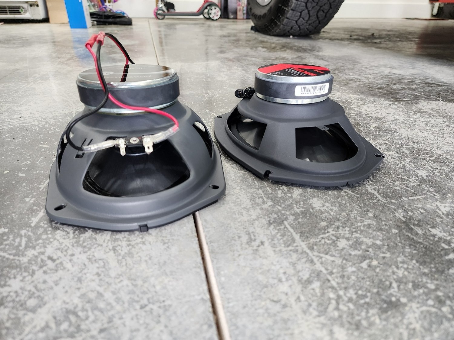

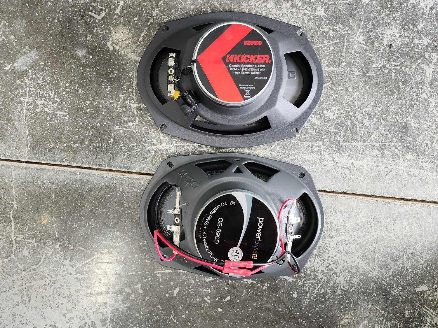

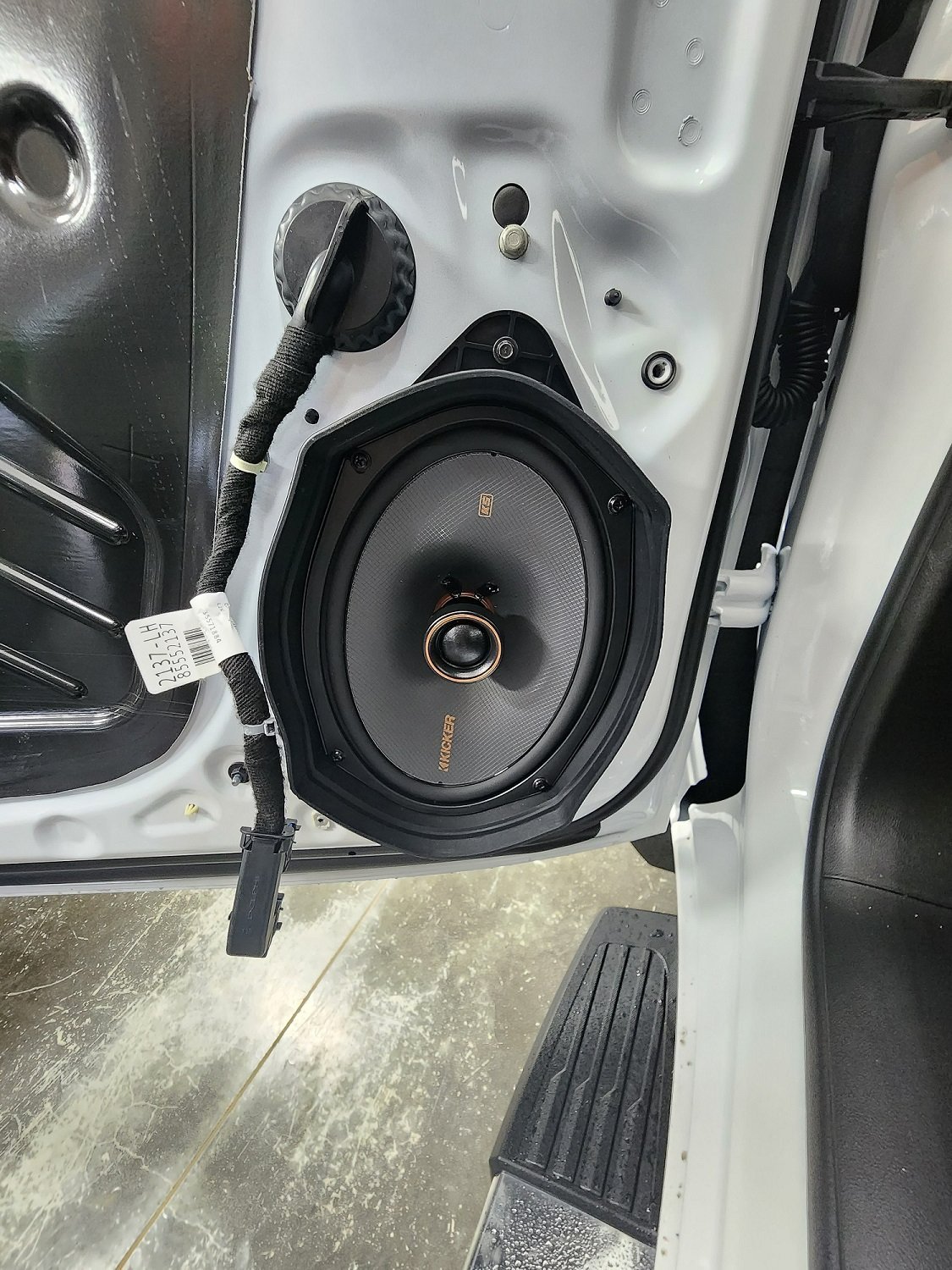

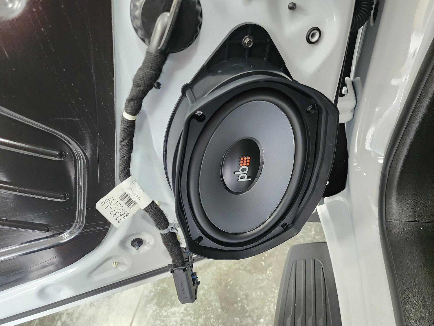

I installed the PowerBass speakers and ran them for a day. They sounded just ok. They almost had the same sound as the OEM speakers. They wouldn't fit with the baffles under the door panel. The PowerBass speakers specifically say in the instructions "Do not use with aftermarket amp". They also only have about 1/2 the RMS power handling that the Kickers have.
I wound up going back to the Kickers with the baffles. My plan changed a bit and probably next month I'll add an amp to power the door speakers so I get the full sound from them. I'll just have to keep in mind the volume will be a little louder until I add the amp.

Wow... thanks for the pics and the update. Was hoping for a better outcome on the PBbusing the 2 ohm jumpers.  Is the OEM front door speakers mid bass or 2 way? Can you hear the tweeters on the Kickers or are there factory Bose high frequency blockers? So the Kickers sound better but just not as loud because of being 4 ohm?  Maybe a low ohm 2 or 3 way would sound better.  PB has a 2 ohm 2 and 3 way which may sound better than the mid bass speaker.  Have you done anything with the rear doors? I think those are 4 ohm. I wonder if changing them to 2 ohm would help?
Not going to say the Kicker's sound better, but there wasn't much difference with the PowerBass speakers. For the cost difference, I'll go with the Kicker's and add an amp to make them really sound better.
I did replace the rear door speakers with 6.5" Kickers. All 6 speakers in the truck match. The rears made a difference over the OEM ones. There was even more difference when I went with the baffles. The OEM rear and dash speakers are 4 ohm. Crutchfield didn't send rear speaker adapters so I went with these instead of the adapters that came with the Kicker speakers. https://smile.amazon.com/dp/B0811YYTNY?psc=1&ref=ppx_yo2ov_dt_b_product_details They are much better built and move the speaker out closer to the door panel. With the baffles installed, there was a significant difference in sound from the rear speakers.
