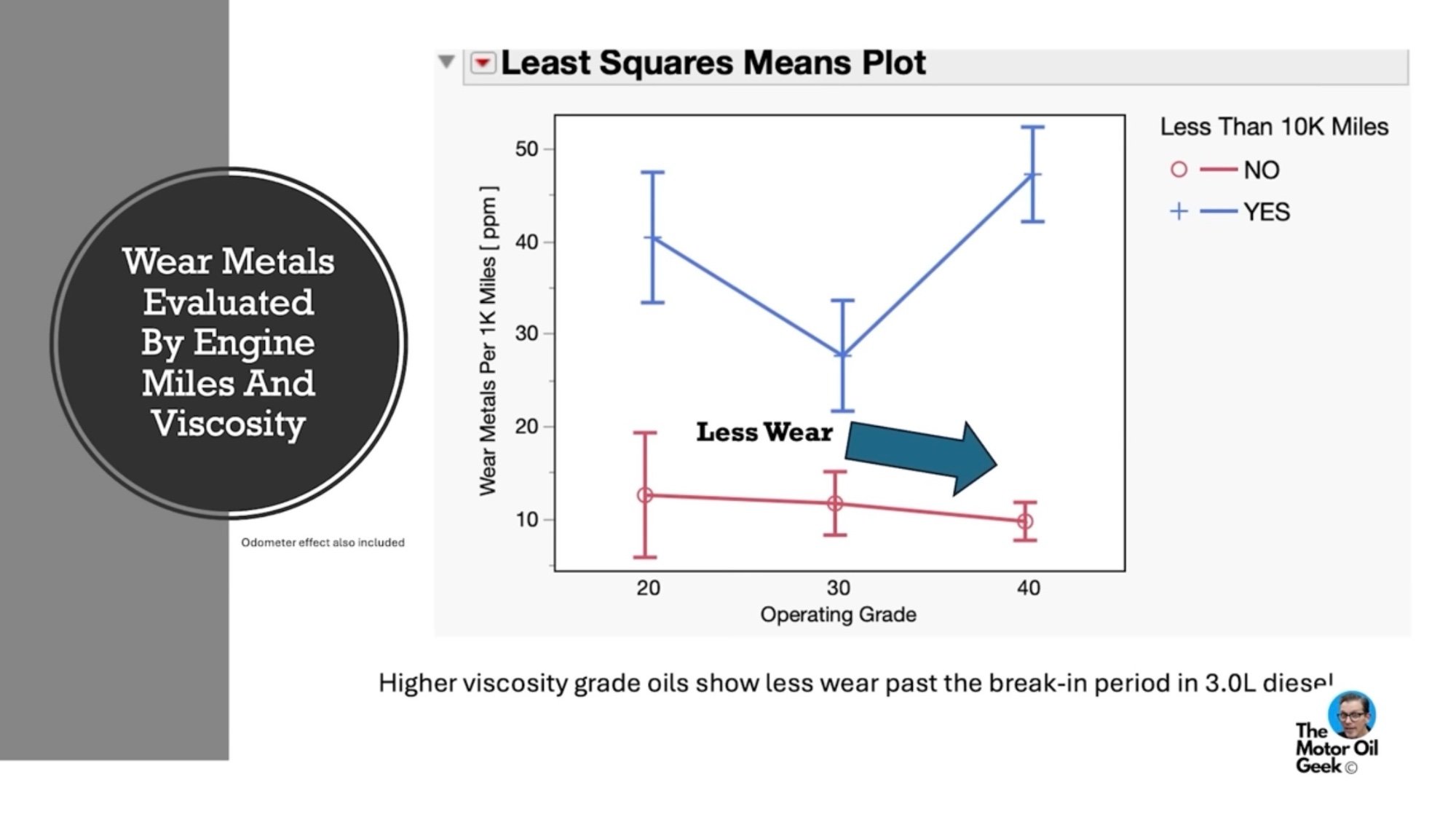

At around 13:00 he addresses high viscosity oil in the 3.0 diesel and the wear reduction.IMG_4792.thumb.jpeg.3e57c2ef50c246c43546f400c2cacde7.jpeg

I'd say Geeks' video validated every thing I've ever said.
Guess it just needed to be said by someone else.
I'm good with that.

GM 3.0 diesel? He never says. What 3.0? European? Soot loading is NOT an issue in modern diesels. Lake mixes up gasoline engines with diesel engines.
The video proves nothing about the GM 3.0 diesel using whatever vis you decide above 9 cSt @ 100c
Again Grumpy and anyone that decides to run more viscous oil in your new under warranty GM 3.0 TD and show the results.

Well, there’s only one 3.0 diesel left in production, and only one that ever called for 0w20. Not hard to read the tea leaves.
The FCA 3.0 spec went from 5w30 to 5w40 before they put it out to pasture. Ford 3.0 was 5w30.

I must have missed where he was talking about the 3.0 specifically because I didn't catch that. He just said diesel engines dirty the oil with soot, and soot accumulation leads to more wear. All true. Soot will accumulate with whatever weight oil is chosen over the OCI.
The takeaway, which he gets to at the end, is changing oil more frequently keeps oil cleaner and reduces wear. I didn't read into a specific recommendation on oil viscosity for the 3.0, just that in general a higher viscosity oil reduces wear according to a chart.
I'm willing to give it credibility, but none of the contributors here nor in anything I've watched actually explain what a higher viscosity oil buys. Is that the difference between 200k and 400k miles or is it more like the difference between 500k and 515k miles, if the rest of the engine components happen to last that long?
If GM recommends 0w20 because they think it's the best intersection of efficiency and longevity and the end user stands to get 200k+ out of the engine on their prescribed oil change intervals, I think that's an acceptable life for a 1500. I'll be done with mine by 200k even if it's in perfect shape.

It MIGHT get you 10 ppm less of iron wear with Exxon Mobil 0w20 Dexos D oil in use.
Most likely mean nothing in 200,000 miles of use.
Use Amsoil 0w-20 Dexos D oil and stay in grade AND have LOW iron wear.
Maybe get you 300,000 -400,000 miles of use if maintained well.
Use a too viscous oil and throw a timing belt, hold heat needlessly among others I listed above from GM design comments.
