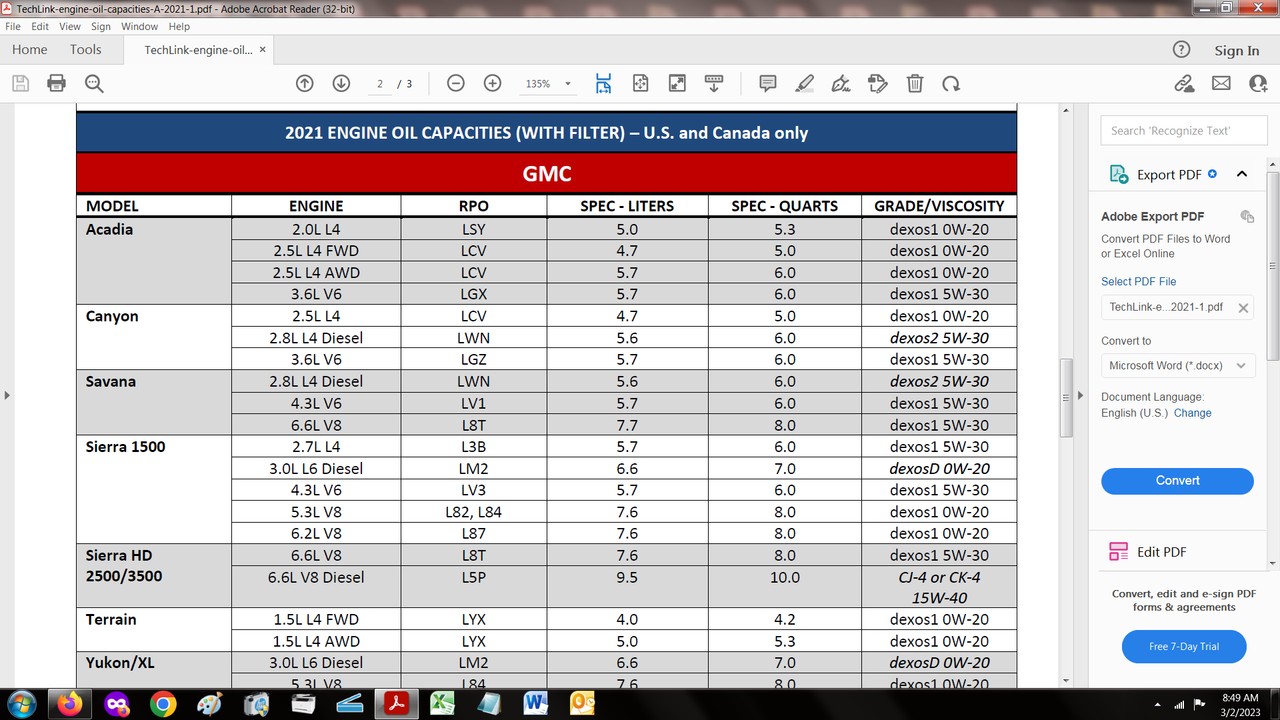

You should have received a duramax supplement to go along with the owners book.  The information is in there, the truck takes 15w40.
Your oil fill cap will agree with the auto parts store.

With the diesel there should be a second owners manual, the Diesel Supplement Manual.
Oil weight can be either 15w40 or 5w40 if you have really cold winters.  Shell Rotella is a popular choice, Amsoil, Chevron, Mobil Delvac, etc.

5w30 is for the gasoline engine.
