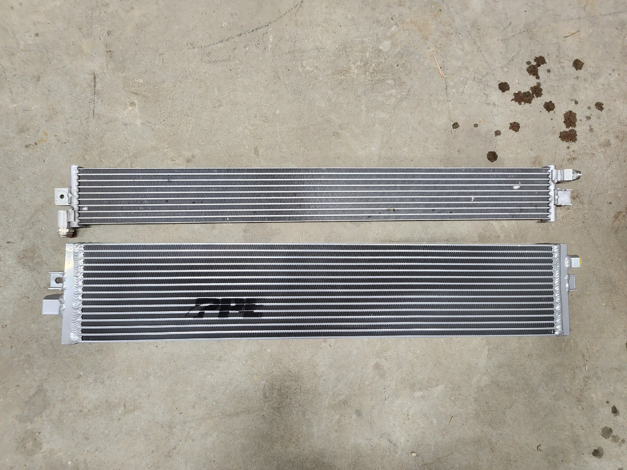

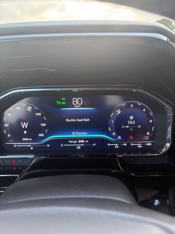

I have the PPE thermal delete block and PPE transmission cooler on my '22 3.0 LM2. My temps under the same conditions as the OP is usually between 140-160*F. I was seeing the same temps as the OP before I installed the PPE parts.
Thermal Bypass Valve:
https://ppepower.com/products/transmission-fluid-thermal-bypass-valve-gm-3-0l-duramax-10l80?rq=yr_2022~mk_chevrolet~md_silverado-1500~ai_6-cyl-3-0-liter-turbocharger&variant=42081986183411
Transmission Cooler:
https://ppepower.com/products/cooler-transmission-fluid-2020-gm-3-0l-1500-bar-and-plate?rq=yr_2022~mk_chevrolet~md_silverado-1500~ai_6-cyl-3-0-liter-turbocharger&variant=42081985265907
This is the comparison of the stock transmission cooler and the PPE.
Edited by mjonesjr84

Update to my original post.  I installed the PPE thermal bypass block on my transmission.  It made a huge difference in the operating temperature.  Today while towing my 5000# travel trailer at 70MPH the trans temp was 151 degrees.   The highest temp I saw was 170 and that was while backing into my driveway.  Installing the thermal bypass block is the only change I’ve made to the transmission system. If you’re concerned about the high trans temps I would recommend considering this modification.
