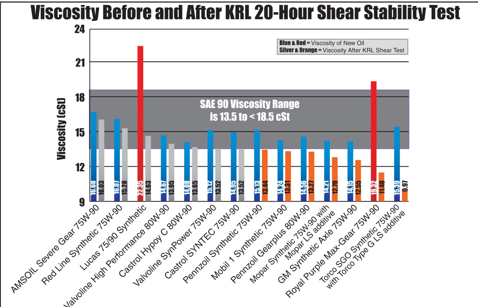

More happens to lubricants than get dirty. Here's a prime example I've posted a few times. Find GM 75W90 and note how quickly it shears out of SPECIFICATION. The change frequency does NOT reflect this. It reflects a lubricant that REMAINS in spec. This is not unique to gear oil and while transmission fluid does not contain polymetric VI improvers it degrades in oh so many other ways. What is GM's path? Lighter oil, 75W85 and longer OCI's. Insane behavior.
Gear oils, transmission oil, and automatic transmission lubes all contain VI improvers, conventional versions use pour point depressants.  PIB is used at about 18% in gear and transmission lubes that contain PAO.  Conventional petroleum using GRP I, II and III use PPD at about 1% of formulation.  ATF usually has 3-10% VI additives. ATF can use up to 0.5% PPD.
All Greek to me. I just change it more often.
AMSOIL and Red Line are PAO based. I get their use in conventional'\, but are they used in these PAO based products? It's a very low straight weight with an already exceptional pour point.
PIB, a dispersant, I get.
