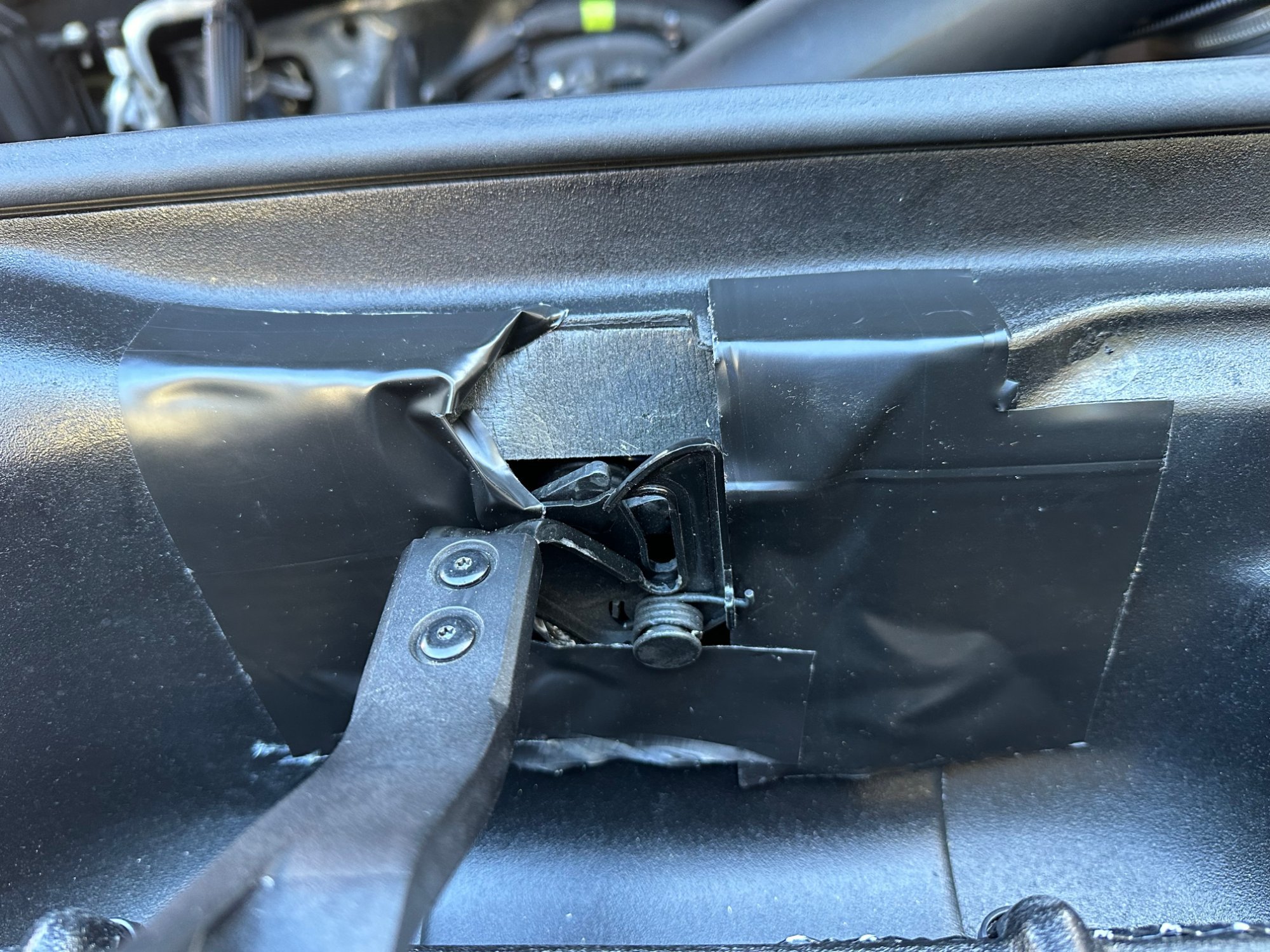

Looks good, congrats on the install.
Suggestions:
1.  Use stainless steel zip ties, the plastic ones wont last long and you don't want them bouncing around in your air box.  You can get stainless steel ties from Home Depot for cheap.
2.  Coat the mesh covering with "Exterior Protective Paint".  The mesh will corrode over time and you don't want tiny metal particulates to be impacting your air filter, or worse yet be sucked through it.
Congrats again on the install, it looks nice.
Good tip on the stainless zip ties.  I probably could do a better job trimming the edges too.  The mesh is coated aluminum alloy.
And I know this is over the tip OCD so criticisms are welcome.  But couldn't stand the thought of that fresh cool air from the scoop escaping thought the hood latch opening.  I know it's meaningless but I was bored I guess.   I'll trim it up a bit later to make it look a little cleaner.
Edited by typhoon186
Suggestions:
Would you be concerned about stainless steel and aluminum alloy affecting each other in ways that cause corrosion?
  • Haha 1
If the aluminum has a coating over it then the stainless will not have a corrosive reaction that dissimilar metals usually have with one another.
