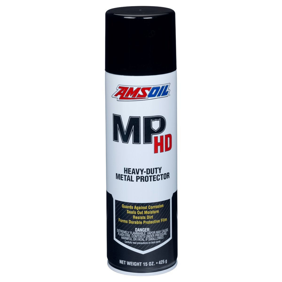

AMSOIL's Heavy-Duty Metal Protector is another option.  It dries to a wax film and I have several customers that really like it. Easy to apply and about 5 cans will cover the average truck underside.   If interested let me know and I can quote to your door with the GM-Trucks discount.
Hmmm.  Sounds comprable to Boeshield?  I've used that before and I like that one but its $$$.
