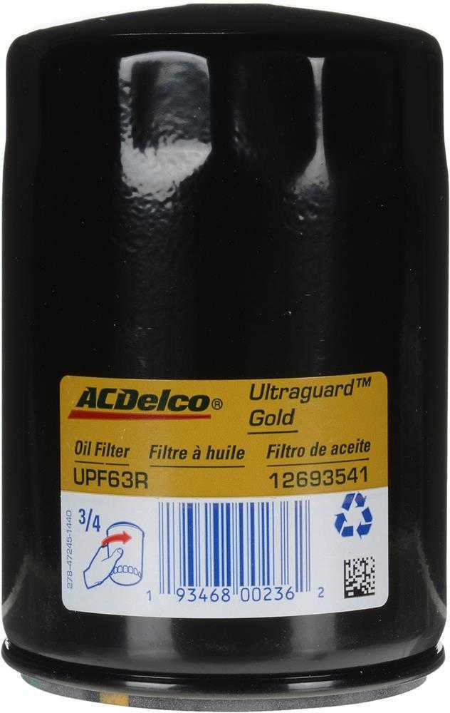

Eh.  I'd run the UPF63R as the PF-63 is the spec'd filter for the trucks.

Didn’t know they made a 63r. Thanks

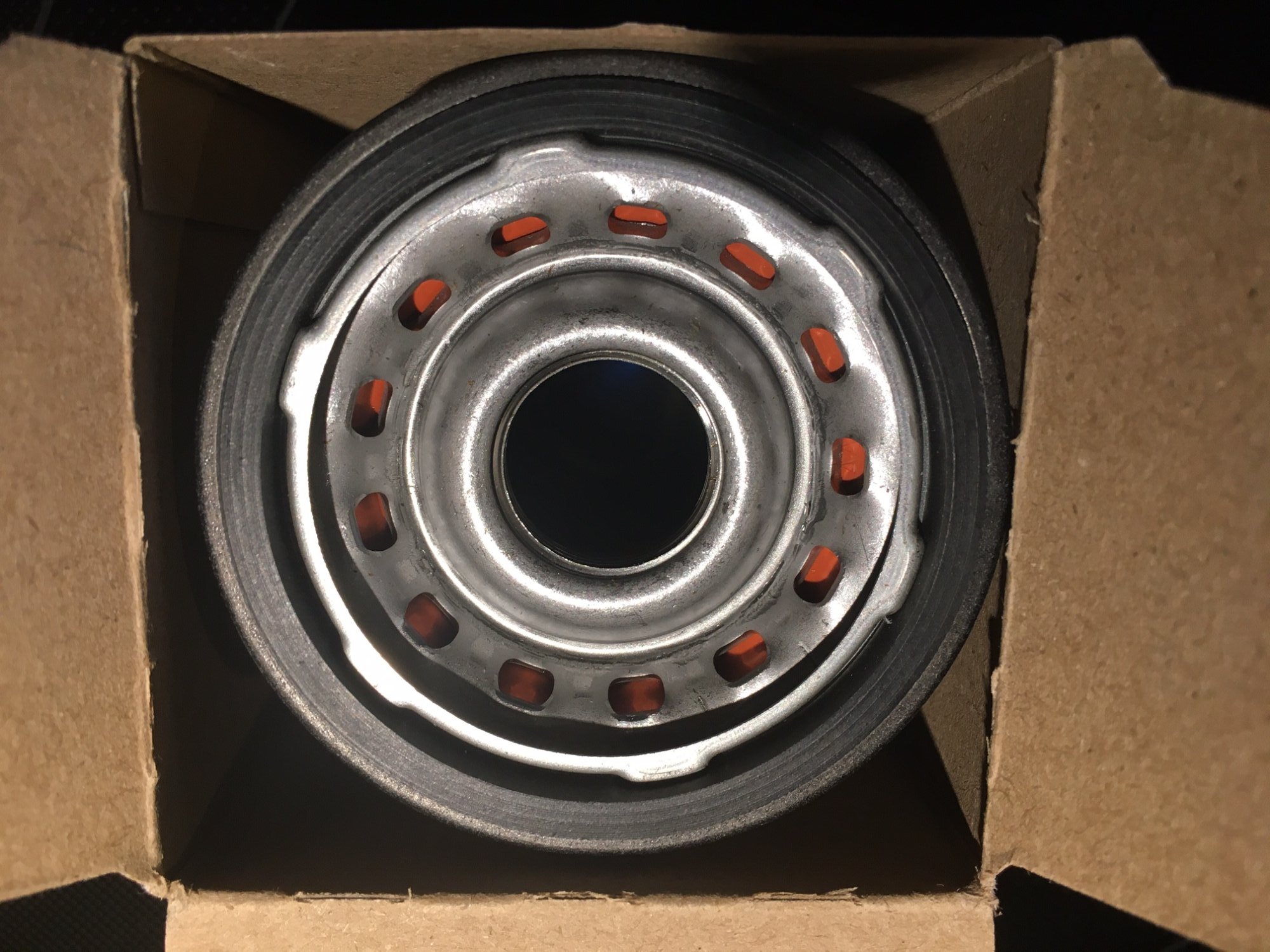

I bought a handful of AMSOIL filters to try from @Black02Silverado for the Mitsubishi. Yes they were a bit over a dollar a piece more than the Purolator Pure One I've been running and on paper have equal 99% at 20 micron ratings. BUT, the difference even in external construction is HUGE. In fact, not another filter on my preferred list is built like that.
I didn't put pencil to paper but the inlet area is vastly larger and the endcap is tank like in construction. Grippy coating, unlike the FRAM XG still allows the proper cup filter wrench to be used. Center tube is crush proof. I got my dollars worth.

I haven't even seen one in person sir. Sorry. I can say that a few places that supply their own filters will recommend the Endurance when they cannot, for whatever reason, supply one of their own. Seems like an endorsement of sorts. Grain of salt required perhaps.
Here's the business end of the ones Nick sent me.

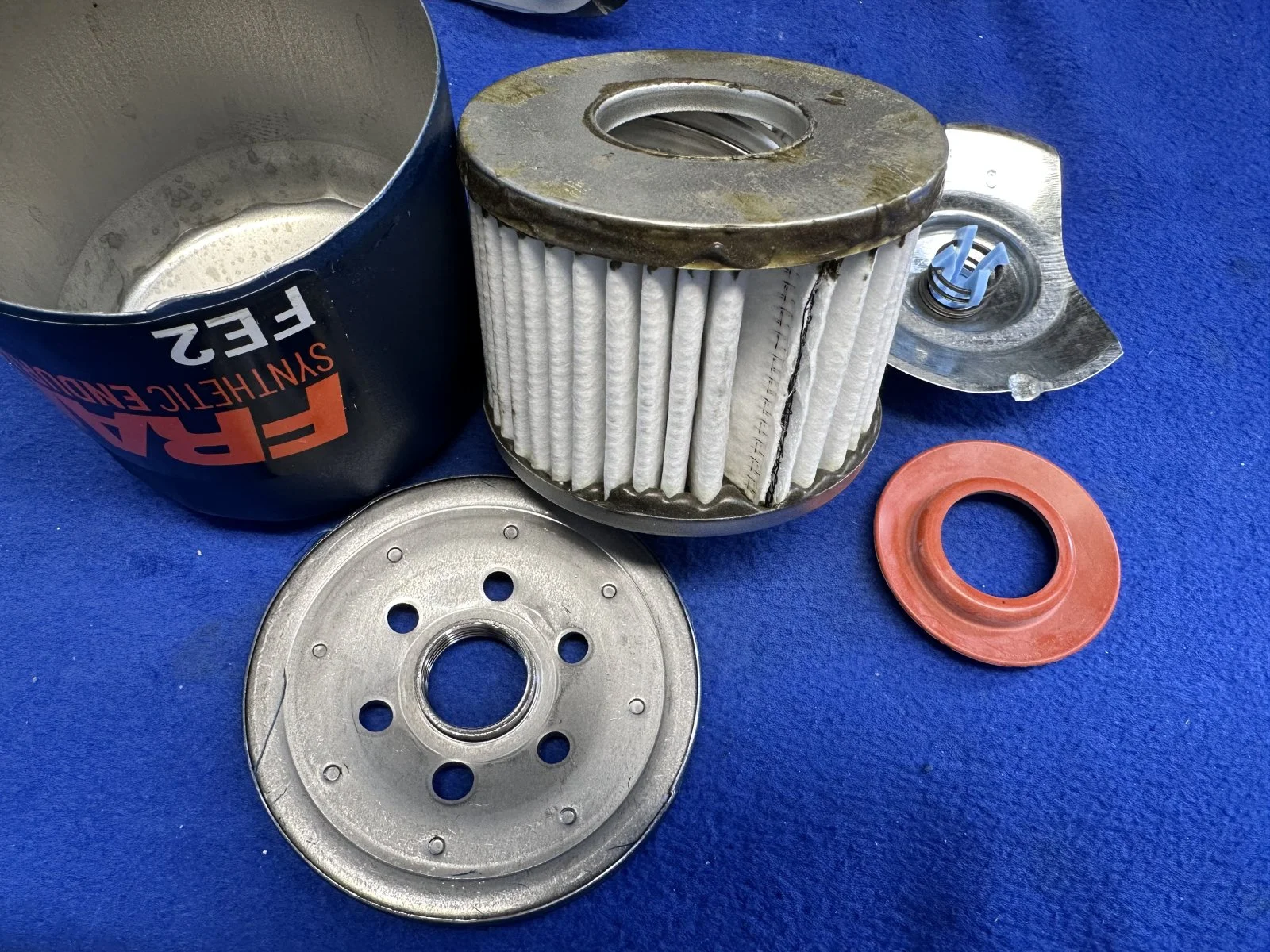

Fram Endurance is awesome. Made by Champion Labs. More than a passing resemblance to the Amsoil. Media looked no different to me when I cut them both open. Can get it at Walmart so it’s pretty convenient too.
Amsoil FF media is Donaldson made. I suspect the whole filter is.
I’m not guessing or “suspecting” when I say what I say. In my application the Amsoil and Fram Endurance are basically the same filter and definitely Champion. Base plate, media, even the little blue clip on the spring. IMG_1452.thumb.jpeg.6fcf5011a746745c2a9a84b61c2eb208.jpeg
Fram
IMG_1454.thumb.webp.94fda35026f8977649df5f33418a8a0c.webpIMG_1453.thumb.webp.e3037bfdef09d7e4d6a1438c5cc32d96.webp

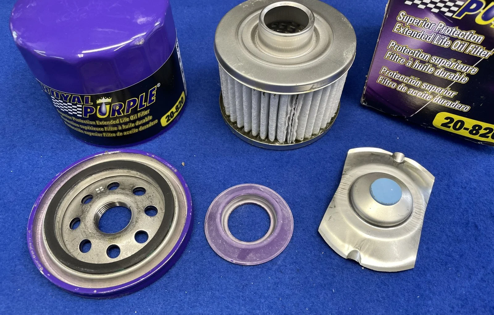

Royal Purple too but the base plate is a little different and the ADBV is purple. 🤷🏻‍♂️
