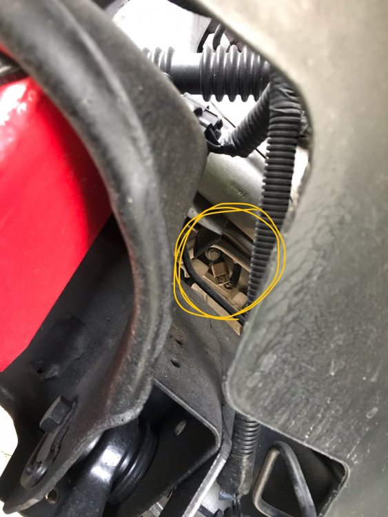

For any of you fellas looking to do a knock sensor job, for my 2012 Sierra 6.2l its not under the intake manifold! LUCKY right? The photo here is the knock sensor for the drivers side. The passenger side sensor is in a similar position. With some extensions and angles on a ratchet it should (SHOULD) be a simple job. (Please edit if my info is incorrect or off)
