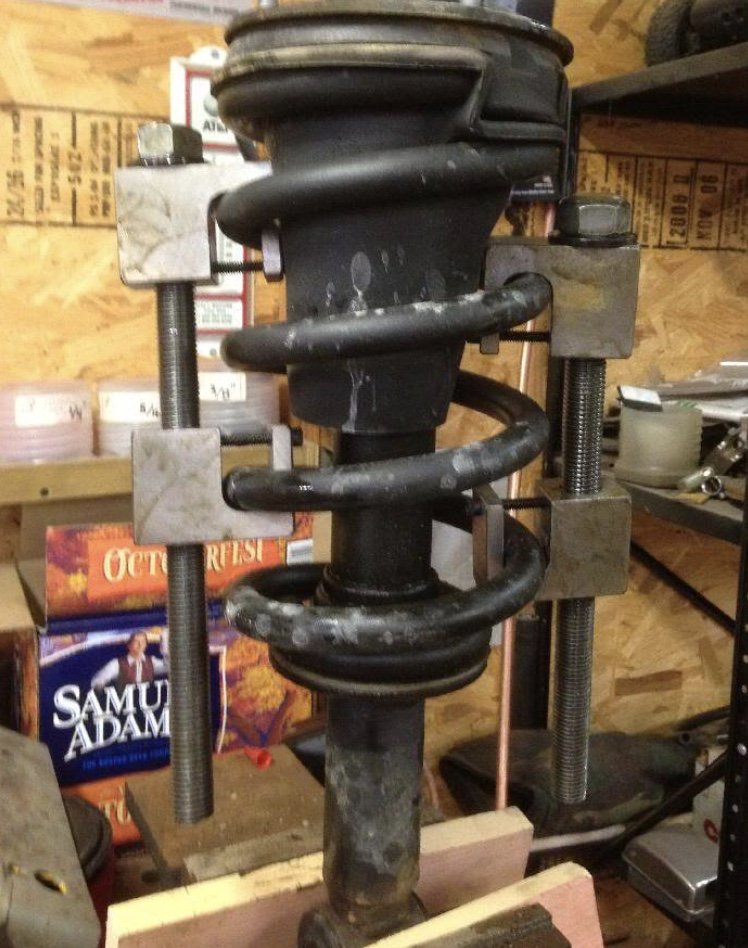

SnakeEyeSS Posted December 9, 2018 Share Posted December 9, 2018 11 hours ago, Mikebtte said: Jsdirt, I used an old set up I have had for ever. Just all thread and some hooks. It was a struggle to make it happen, good hour to swap 1 spring. I would not recommend the process to anyone. Ya, the ball joint seems common, I fear taking to dang truck off road, always think I'll end up with a bad joint. Welcome. And No kidding, my last suspension job was an 07 Tahoe, and I couldn't get the main nut off, so I took the assembly to a shop to remove the one nut. Two hours later THEY hadn't done it. I asked them to at least compress the spring and THEIR air powered compressor couldn't compress it. Well, ticked off at their lack of ability despite high end tools, my father(who was giving me a ride since my daily was obviously down) and I just did it in the parking(just to prove it could be done) lot by hand, because I didn't care at that point if something broke, I was ready to replace whatever. We found out the guys at the shop were afraid to after realizing how strong the thing is. e WWehen they realized they were all lined up to the window watching us do it. When I had the thing in pieces I displayed it to them like a trophy. On top of that one of the new struts was a Z71 strut inside a computers controlled shock box. The worst part? One of the new suspension pieces was defective, only lasted two weeks. (The whole story and my rampant frustration and dismay is in this thread, mid July 2015.) This story is one of the reasons I recently invested in overpowered power tools. And one of my many automoite disasters. Stick around and I'll end up buying something that turns into a ridiculous project or disaster sooner or later. It's kind of my thing. Quote Link to comment Share on other sites More sharing options...
Jsdirt Posted December 9, 2018 Share Posted December 9, 2018 I do this for a living, and don't have a tool capable of compressing that thing! Neither did any of the shops in town - their reaction was the same when they saw it - "Holy crap!" Back then the truck was still pretty new, so they might have something by now. The press I need to handle these things is $750+. No idea what you guys built, but I'd love to see a picture of it. Maybe I'm just getting soft at my age! Quote Link to comment Share on other sites More sharing options...

HoosierZ Posted December 9, 2018 Share Posted December 9, 2018 2 hours ago, Jsdirt said: I do this for a living, and don't have a tool capable of compressing that thing! Neither did any of the shops in town - their reaction was the same when they saw it - "Holy crap!" Back then the truck was still pretty new, so they might have something by now. The press I need to handle these things is $750+. No idea what you guys built, but I'd love to see a picture of it. Maybe I'm just getting soft at my age! These worked for me. I used 20mm threaded rod for the screws. 1 Quote Link to comment Share on other sites More sharing options...

Jsdirt Posted December 9, 2018 Share Posted December 9, 2018 7 hours ago, HoosierZ said: These worked for me. I used 20mm threaded rod for the screws. Nice - thanks for the pic. Looks up to the task from here Quote Link to comment Share on other sites More sharing options...

SnakeEyeSS Posted December 10, 2018 Share Posted December 10, 2018 (edited) 17 hours ago, Jsdirt said: I do this for a living, and don't have a tool capable of compressing that thing! Neither did any of the shops in town - their reaction was the same when they saw it - "Holy crap!" Back then the truck was still pretty new, so they might have something by now. The press I need to handle these things is $750+. No idea what you guys built, but I'd love to see a picture of it. Maybe I'm just getting soft at my age! Didn't build anything. Used the compressors you rent at parts stores. I had bought mine own but they bent so much I went to rent some too, but they did the same. I think we tried four on one spring but that was a cluttered mess so went back to two and they were a scary shape by the time we got everything apart. Ended up mostly straight by the end when loosening if I remember correctly. Edited December 10, 2018 by SnakeEyeSS Quote Link to comment Share on other sites More sharing options...

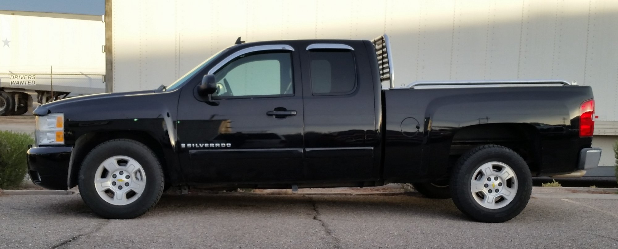

Mikebtte Posted December 10, 2018 Share Posted December 10, 2018 Went from leveled to lowered. The wife inevitably had more important plans that needed done so the rear will have to wait till next weekend to be lowered down. Quote Link to comment Share on other sites More sharing options...
Mikebtte Posted December 10, 2018 Share Posted December 10, 2018 On 12/9/2018 at 7:36 AM, HoosierZ said: These worked for me. I used 20mm threaded rod for the screws. This is what did the trick. I had an older set up with smaller diameter thread that was bending like crazy. Nice set up Quote Link to comment Share on other sites More sharing options...
