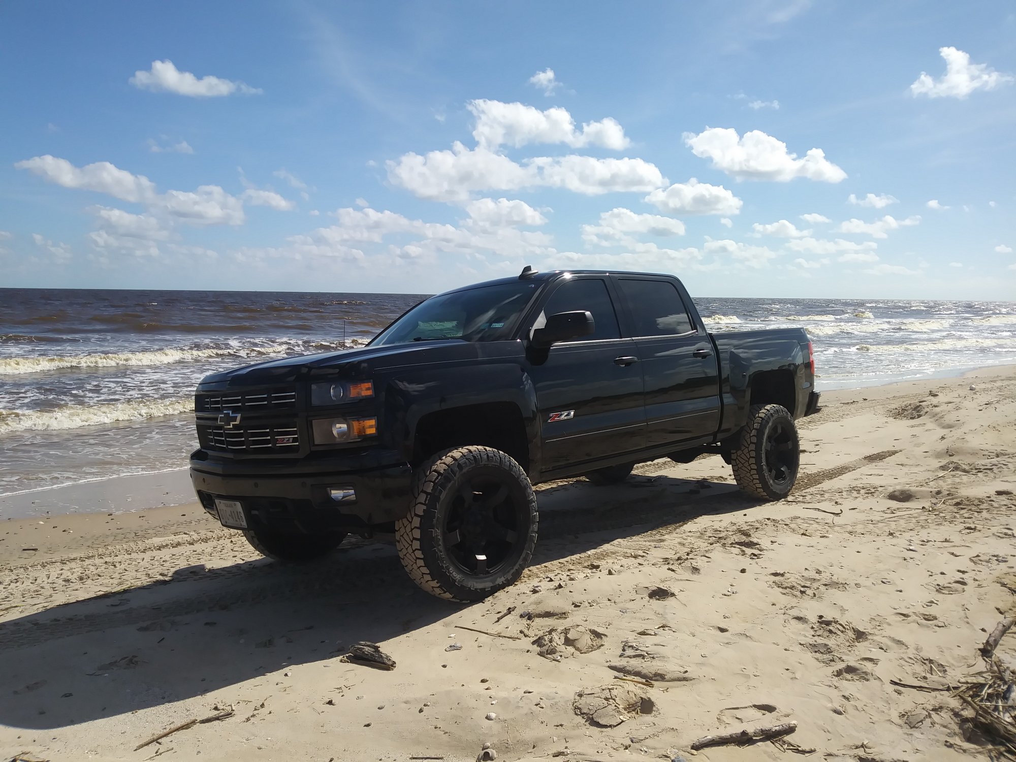

 I went with the zone 4.5 zone..  And added a leaf in rear.
I kinda wish I went higher....
Gonna go up a notch on Bilsteins.....  Soon after all settles......
Truck looks great. if you had to guess, just how far out did the Zone push the front track? I really don't want to push the front track wider, but I don't want an RC bracket lift either.
Also, Who did the lift? Yourself or a shop in the Houston Area?
It pushed out inch& half.
I had a local shop.  Cutten Customs install.
Using a 4 inch block in rear and adding a leaf really helps this truck a lot.

looks fine to me! What wheel and offset? I'd probably change from a 0 offset to a +18 - +24 if I go with a Zone. Cutten Customs has been around for a couple decades, they do great work work. Also, one of the few authorized Zone dealers in our area from what I understand. Thanks again for the info.

Yup no problems.  Truck drives and performs great.  Gonna get a good test in few weeks..   Going to Moab ?
Wheels are 20X10 but a -12... Running a 34 inch X 11....  So I stick out little further than I want.  I already had the custom rock stars before the lift.
1 hour ago, Bigrich said:
Wouldn’t think you would need anything in the rear?
These newer trucks only have 3 leaf springs in rear.  They squat easy with little load and ir towing.  The extra leaf helps a lot.
