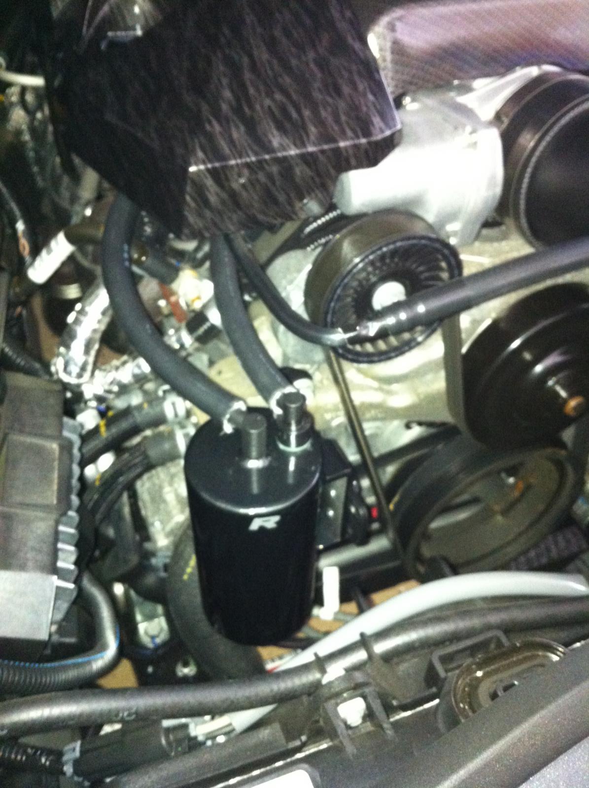

Here is my RX on my camaro
I'll hope the Jegs will do a decent job or I will be right on top of the RX unit myself. Thought I would give this a try and see how it all plays out.

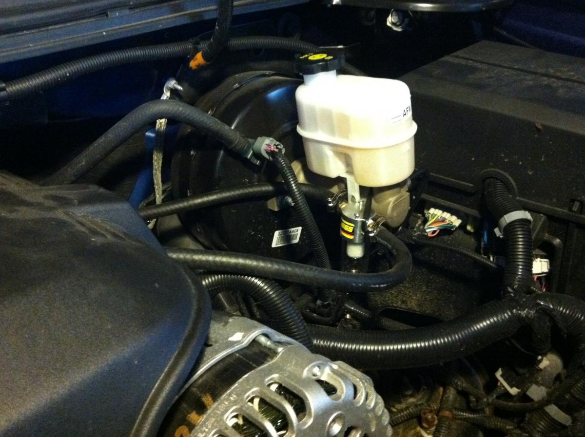

I basically just installed mine in the car (looking at getting a Mike Norris Can in a few wks for the truck) however most people just drain the can at each oil change. You dont get all that much out from what I hear so it would take a long time to fill it up. Its easy enough to crack the drain and drain it while doing an oil change.
And then there's the cheap-*ss solution, but it works so who cares.
You really ought to do your engine a favor and put one on, whether it be bling or cheap.

Decided, just for grins, to see how much oil had been trapped out of the PCV system in just 130 miles since I installed the unit last night. Jerry...... take notice what you and GM don't think is a problem......
I added one of these as well earlier this year. If you removed the air intake tube from the throttle body, there would be a small puddle of oil sitting in the throttle body. Installing a PCV catch-can system like this has now completely ceased this from happening. Good insurance on a brand-new throttle body I bought...mine looks a lot like the one RyanbabZ71 has....
