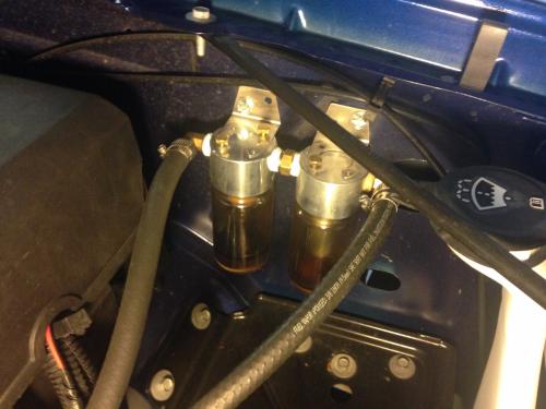

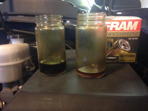

for comparison, the Conceptual Polymer reservoir jar is 2" wide by 4" tall. The standard version uses the same filter at the Jegs unit. The top end version uses a much more refined filter that does a better job, using two different filter medias inside it. I use both, hooked inline. The standard for the first can, and the high efficiency filter for the second. Both with 2" x 4" reservoir jars. No need to pop the hood after a day of driving and dump it.
My CP setup....

Seeing is believing! I wondered when I decided to put a catch can on if it was just a gimmick mod. I now am bumping up against 22,000 miles on my 2013, and the catch can setup has captured an average of 1 oz per 1000 miles. I have long since filled up a 16 oz drinking water bottle and just keep it around for discussion purposes. The winter, the stuff is usually milky looking like you guy's photos. In the summer, it stays primarily looking like oil. It is amazing the amount of condensation that builds up inside the engine and then gets sucked right back into the intake. But not on mine!
