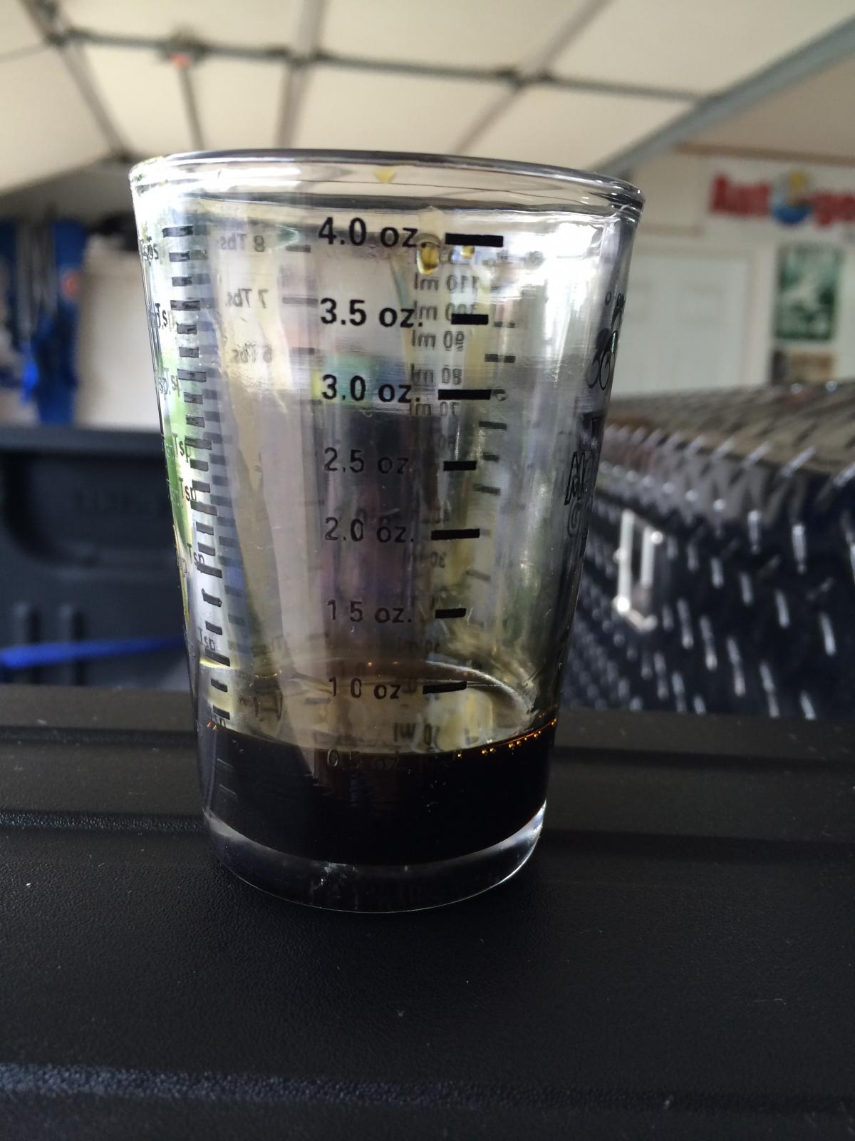

Decided to change my oil today. Have 6150 miles on the oil and the PCV catch can. Here is a pic of the oil it has caught in that time. The oil level was down at the first notch below full, which would equate to about 1/2 pint of oil got used. From this picture, I know where a lot of that oil went.

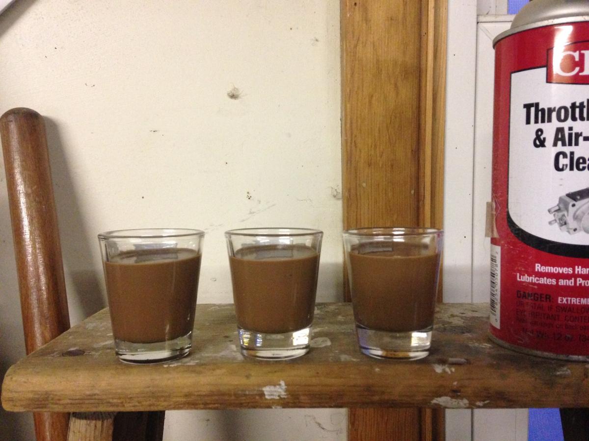

Appx 3500 miles since I drained last time. Seemed pretty watery. I assume because of the cold temps the last 2 months
Ryan
Yeah, the winter months have made what I am catching more watery. That is primarily why the chocolate milk looking stuff in the shot glasses I posted. I was pouring everything I caught into a used drinking water bottle and it was mixing. What's great is that, whether oil or condensation, we are getting that nasty crap out of there before it makes the intake.
Appx 3500 miles since I drained last time. Seemed pretty watery. I assume because of the cold temps the last 2 months tepe5a5e.jpg Ryan

That's what was in my catch can not what came out of my oil pan. It's a combination of water (condensation) and oil.
Ryan
