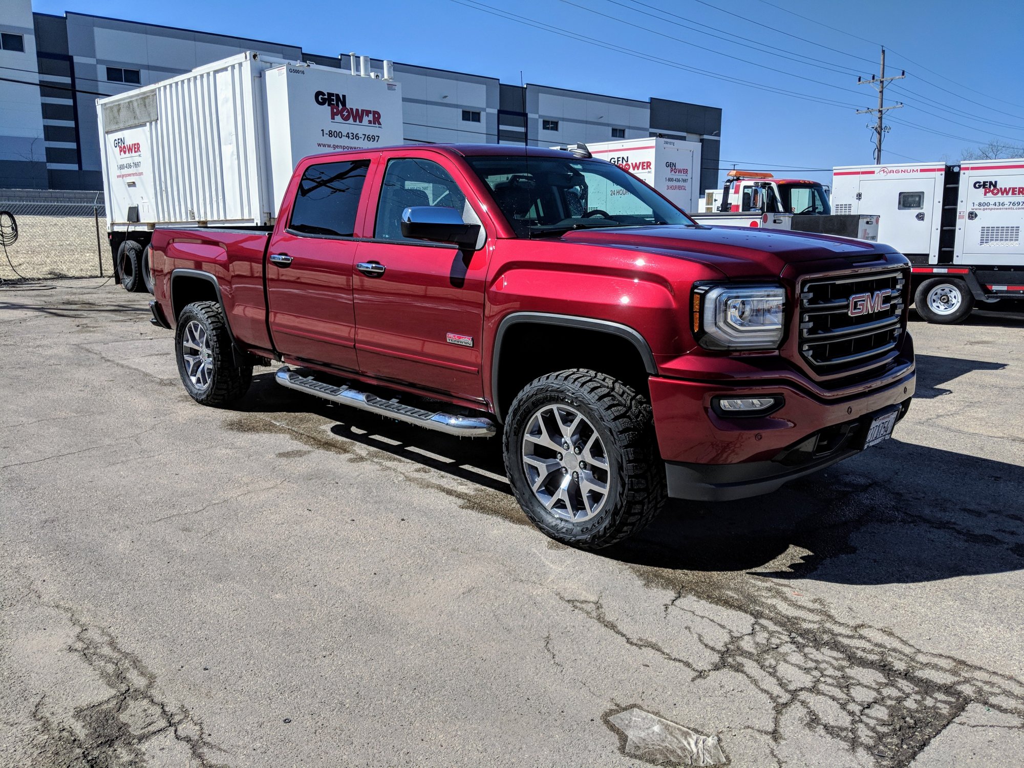

Finally received my BORA 1.25" spacers. Glad to report no more rub while on a 2.5" motofab level with 33x12.50's on stock AT wheels!IMG_20180407_104530.thumb.jpg.6eb1d241e09b4bd3e72ce2b59efa2438.jpg
That looks great.   I've heard you can run 1" spacers without trimming the studs if you have the pockets in back of your wheels.
They are 20" rims on your truck, right?
Thanks brother! Yes, the stock 20" All Terrain wheels. I would definitely trim the studs some on a 1" spacer. I did not trim any on mine as I do have the "pockets" in the back of the wheels which I did not know about until I unpacked my cut off wheel. Surprise to me! I did a quick measurement with my pinky finger and had a little left inside the pocket. Very pleased with the poke and stance of the truck after the BORA spacer. HIGHLY recommend these to anybody in the market. I'll get a picture of the poke when it's not snowing here... Thursday is suppose to be 75° here in wonderful Chicagoland.
