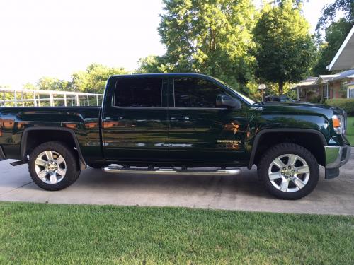

44 minutes ago, WT432 said:
I have a 2015 GMC Sierra 1500 Z71 4x4 Crew Cab all stock with 265/65 -18 inch Wheels/rims. I was wanting to raise or level out the truck, but still want a slight rake for payload. I don't want the front higher if i put anything in my bed. I have read many forums comparing the 2 inch RC in the front vs the 2.5 inch level RC changing the front and rear. The only discussions i have seen involve non z71 trucks.  For those who have a z71 truck which one do you prefer?
My plan was just to do the basic RC 2 inch level in the front and go with 285/65-18 tires, but would hate for the nose to be too high. Should I stick with my plan or go to the 2.5" or find a 1.5" level in the front. Thank you
Get measurements. I got the 2.5" and have only installed the front, it's a tad nose high but honestly I can't tell unless I pull a tape on it or if it's sitting just right. If you do the 2.5", put the rear block in. I'm gonna put mine in just to see what it looks like. This is on a 2014 Z71.
Edited by thutchi3
Just go with bilsteins at Max height. FHLH (user on here) has them with the exact tire size you're looking at and the truck looks great.
