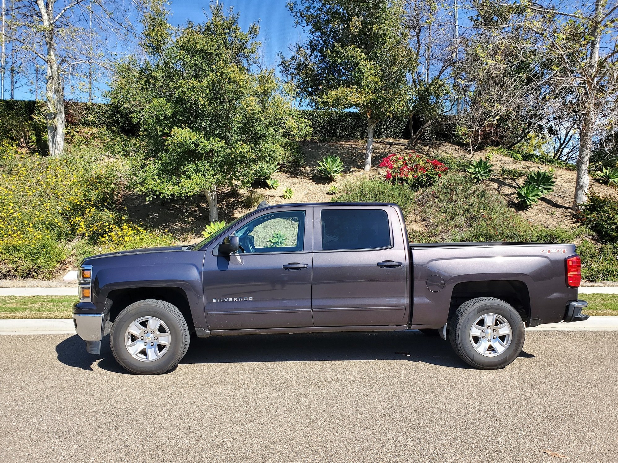

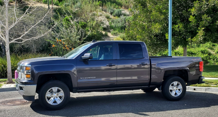

Put my motofab 2" leveling kit in yesterday.  Took about 4 hrs, which included 2 trips to Home Depot for some missing sockets and combination wrenches.  I was able to torque everything back to factory specs, except for the top strut bolts (no way to get a socket over those) and the upper ball joint (again, no way to get a socket in that tight space).  Taking it in tomorrow for alignment.
I am VERY happy with how it turned out.  Before and after pics below (I didn't take the most flattering "before" pic...)

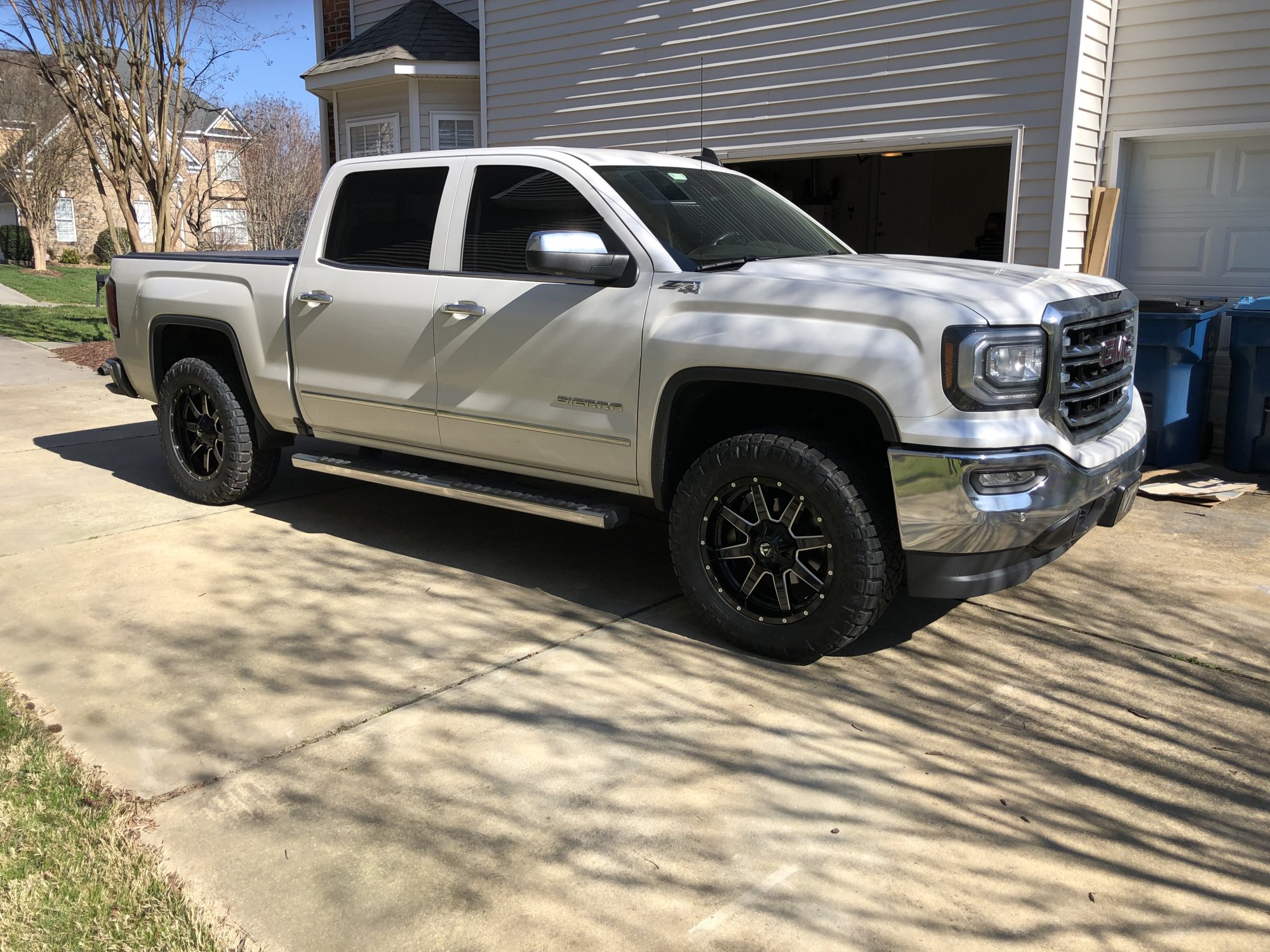

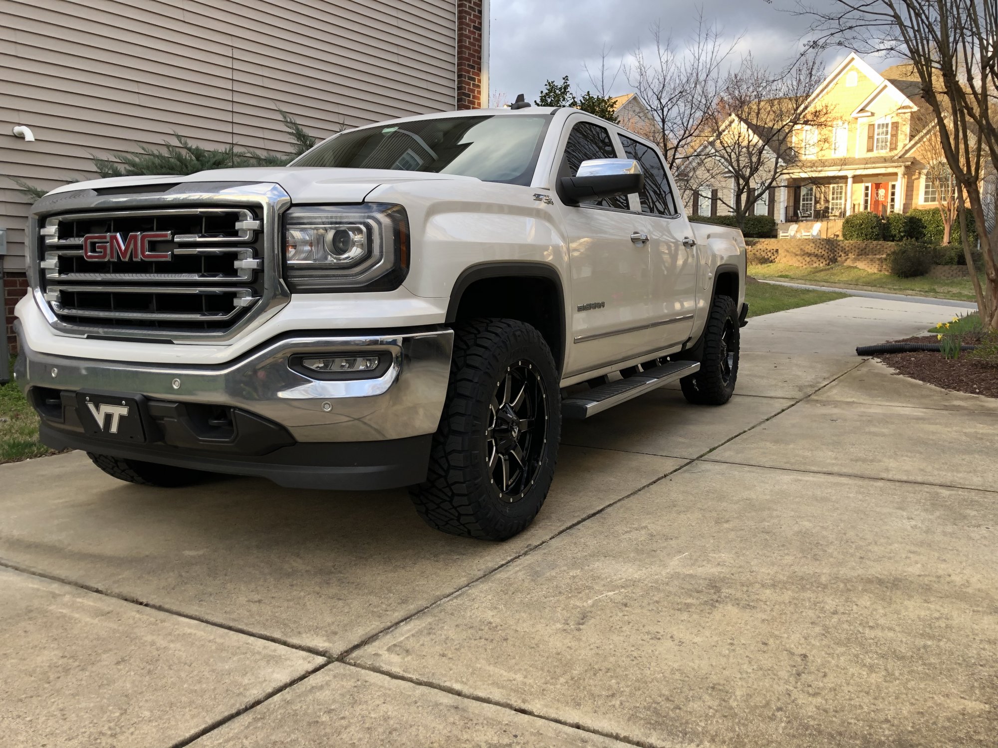

I’ve been reading and reading before deciding what to go with on my truck.. finally got it finished.. motofab 2 inch level, 20x9 Fuel Mavericks +1 offset, 295/60/20  (34x11.75x20) Nitto Ridges.  Minor trimming, Just barely rubs at full lock on the carpet.. nothing else.. love the look and the stance!
Great looking truck! glad to see no major rubbing or trimming, wanting to run a 34” tire on a 2.5” leveling kit here soon

With my 2 inch kit it sits 1/8 higher in the back.. you might sit a little nose high with 2.5

Got my alignment done yesterday, so I'm good to go now.  The toe was quite a bit off, but everything else was in spec.  Again, I'm really happy with how the 2" level turned out.  Exactly the look I was going for.
