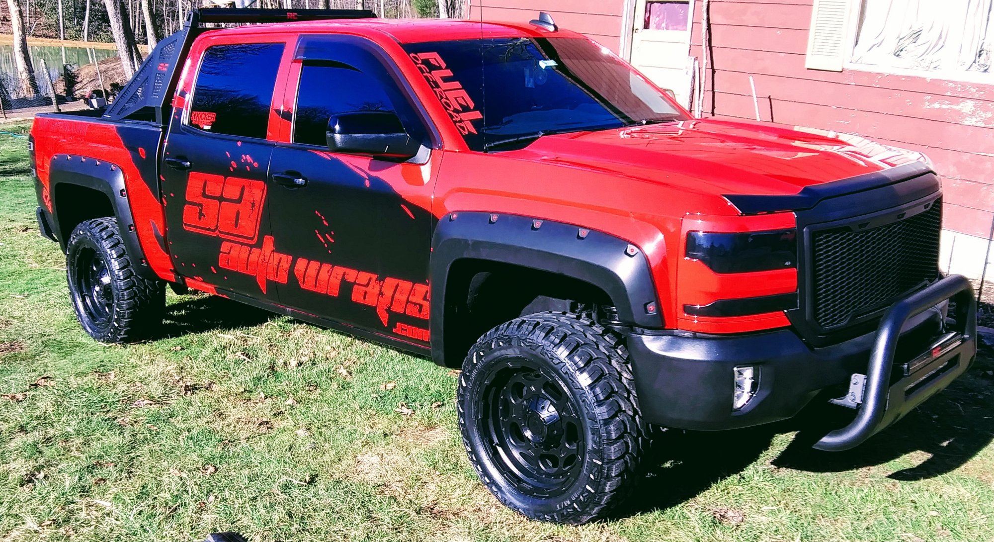

Finally bit the bullet and got wheelsand tires. My 2016 Silverado 1500 Rally 2LT with ready lift 2.25 and UCA and Zone add leafs.
I went with 2019 GMC Sierra SLT replica wheels in gloss black and LT275 65 R20 Duratracs. Upgrading from 285 45 22 bridgestone duellers. What a difference. You would never know these are a 10 ply tire. Great ride.
To prevent UCA rub, I fabricated some steering stops and tack welded them to the lower control arm. I made them over size and then ground them down to a perfect fit. Lost 6 degrees of turning radius as indicated on the dash, but i dont care about that. I rarely max out my steering. I did this so I didnt have to run a wheel spacer. Trimmed the corner of my mud flaps too. No rubbing at all982e4efd068e0214a1c489ee4a0979b9.jpg
Sent from my SM-G950U using Tapatalk
More pics. Pardon the excessive fluid film on the control arms lol. 06140ba1dafd8ae5df655596db4aba49.jpg15722f2b551ea1211f1026e9af359081.jpg6e751727a3466e897d112b640b02e82a.jpg420872c781b78649132dd738a3000e83.jpg
