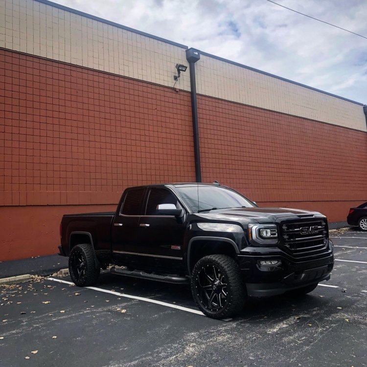

2 hours ago, Sierra Jon said:
That looks awesome. What brand kit and size tires did you go with?
Sent from my Pixel 4 XL using Tapatalk
I went with the 2.25in readylift kit with the upper control arms and 33x12.5r22 nitto ridge grapplers. Looks way better in person I just suck at taking pictures
Lol thanks. It looks perfect dude seriously.
I really didn't want to go load e tires because of the weight so I'm contemplating either staying with the same size tire or downsizing to 20".
First world problems...

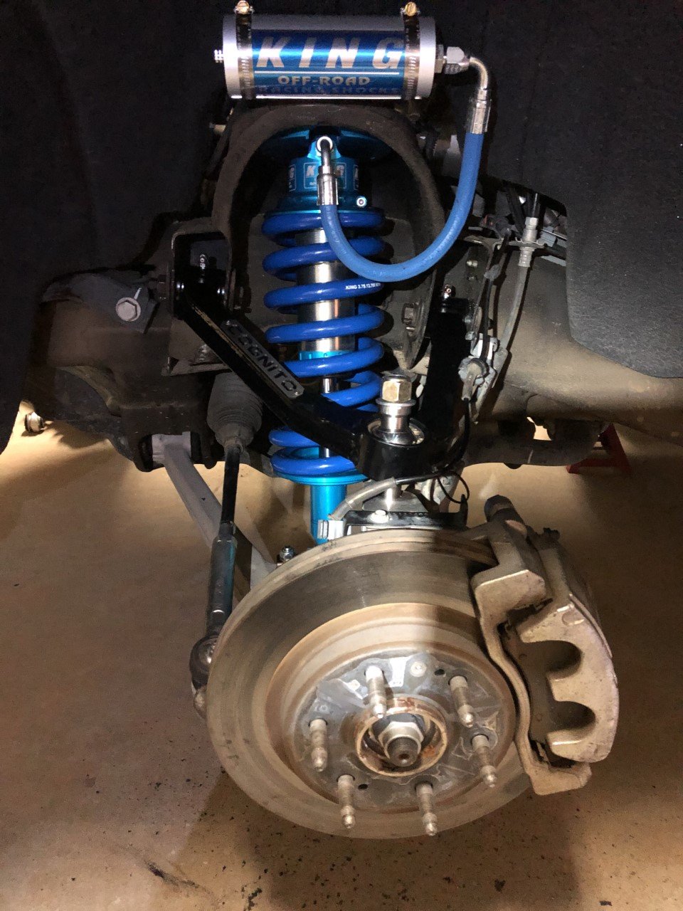

Got sick of the crappy Rancho ride, through a lot of reading and researching, I decided to go with FOX extended length 2.5's and the cognito UCA. After a week from ordering, I was called and told the Fox won't be manufactured until September. I was offered a set of King's for cost and they were in stock, couldn't pass on that. Finally got them all installed last Friday and alignment done yesterday. Before this, I had a 2" top spacer with a ride height of 23.5" ( center of hub to fender) and now I lost only .5 with a stock setting on the shock. It looks ok to me, and I can live with the 1/2 inch till I need new tires and then I will crank it up a little. My rims are stock 20's and the tires are BFG KO 275 65 20. My does this truck drive nice on the road and off.
Edited by tjrado
Added pic
