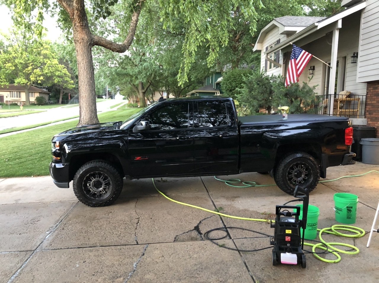

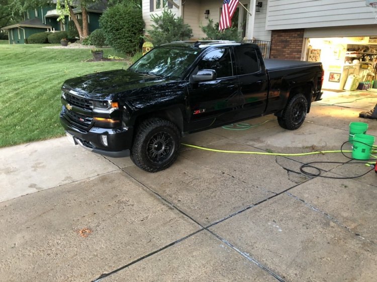

I just got my leveling kit installed and my new nitto ridge grapplers. Im happy with the look
That looks awesome. What brand kit and size tires did you go with?
Sent from my Pixel 4 XL using Tapatalk
