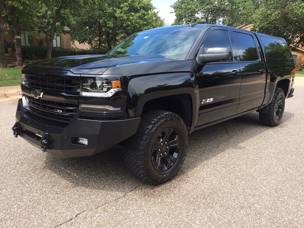

looks a bit familiar...I only added  a RC 2" level and 285/65R18 KO2s on my stock rims... I'm please with the stance...
post-162426-0-99530500-1503328109_thumb.jpg5b1e6d734ec86_truck1.thumb.jpg.8ea1c2e9459482fe32ec29511d267278.jpg
Edited by spenpet
How much room do you have with the 285/65R18?
275/70R18 : 33.20" x 10.80" (1.6" taller and .40" wider than stock
Not much of a increase over stock......I know I could fit a 275 series easy, but also like the wider tread
285/65R18 : 32.60" x 11.20" (1" taller and 0.8" wider than stock)
285/70R18 : 33.70" x 11.20" (2.1" taller and 0.8" wider than stock)
285/75R18 : 34.80" x 11.20" (3.2" taller and 0.8" wider than stock)

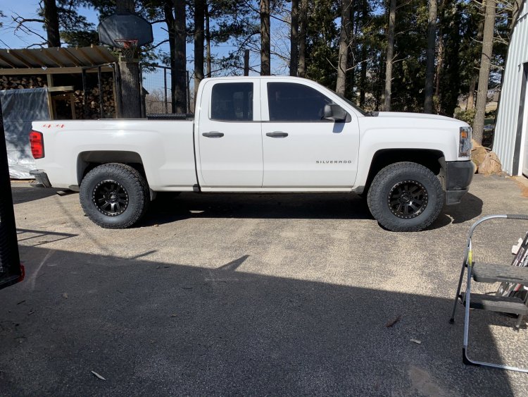

Went with the pro comp pro runner shocks, front is leveled just under 1.8”.
Did you have to trim any metal to fit those tires?
Nope just had to do the normal trimming on the plastic. I bought some trim plates just in case, but I didn’t have to use them.
