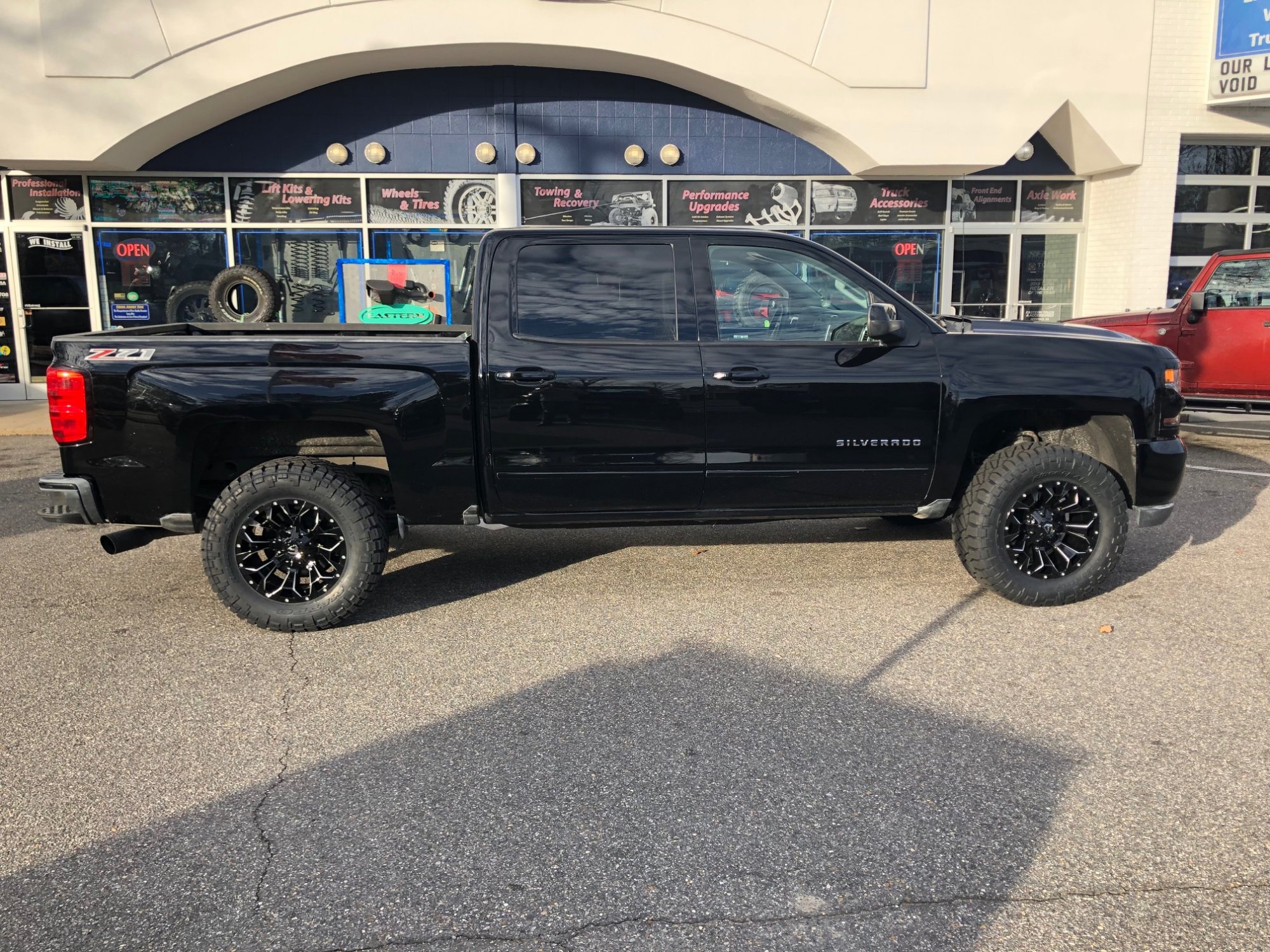

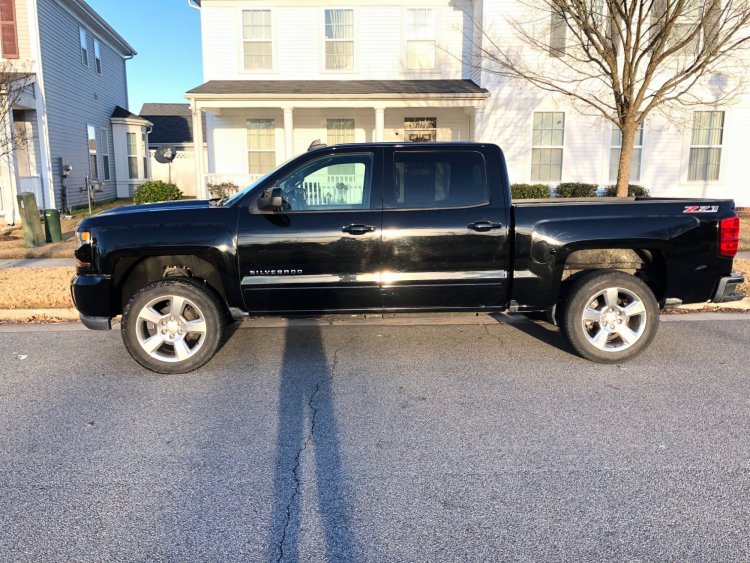

2018 Chevrolet Silverado LTZ with 295/55/20 Nitto Ridge Grapplers and a 2 inch rough country leveling kit. I know a lot of people like aftermarket wheels but i love the stock LTZ 20s. Thinking about possibly doing the 2.5 kit on the front and the 1 inch block in the rear.
Any rubbing issues at all? I played it safe with 275/55/20 with 20x9 wheels with a 0 offset and don't have much room to spare when turning on level ground. Especially don't want to be in the woods somewhere end up tearing the wheel wells apart once the suspension has some articulation to it but think I could have gotten away with a little bit bigger tire with a RC 2 inch leveling kit installed
Some times at full turn to the left it will rub but it has to be fully turned. I never really have it locked anyways. I am sure the two inch leveling kit helps with that. I have been really pleased with the set up.

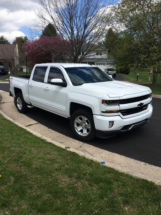

I have a 2017 1500 4x4 i just purchased and it has bout 3 1/4 inches from front to rear, measuring from center of wheel to fender well. Way too much rake for my liking, it has factory 22" wheels. Just want to level front and put wider tires on or possibly switch to 20" wheels and tires? Any suggestions on which leveling kit and how much bigger can I go on tire size for both scenario's? Tire size on it now is P285 45r22. thanks in advance
Saw this today. Couldn’t tell what size level but had 285/65r20 K02’s. I didn’t see markings on the UCAs but it did have the fender liner zip tied back. Was a sharp truck.

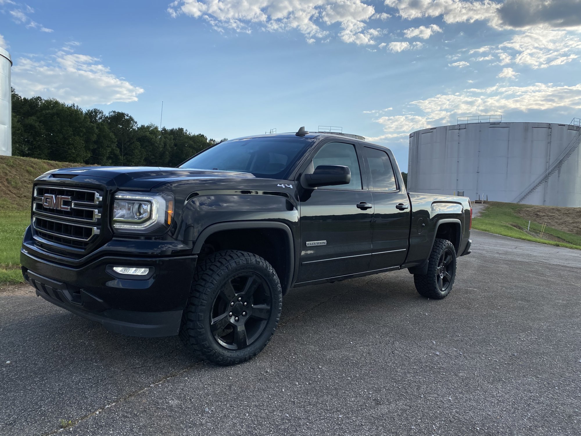

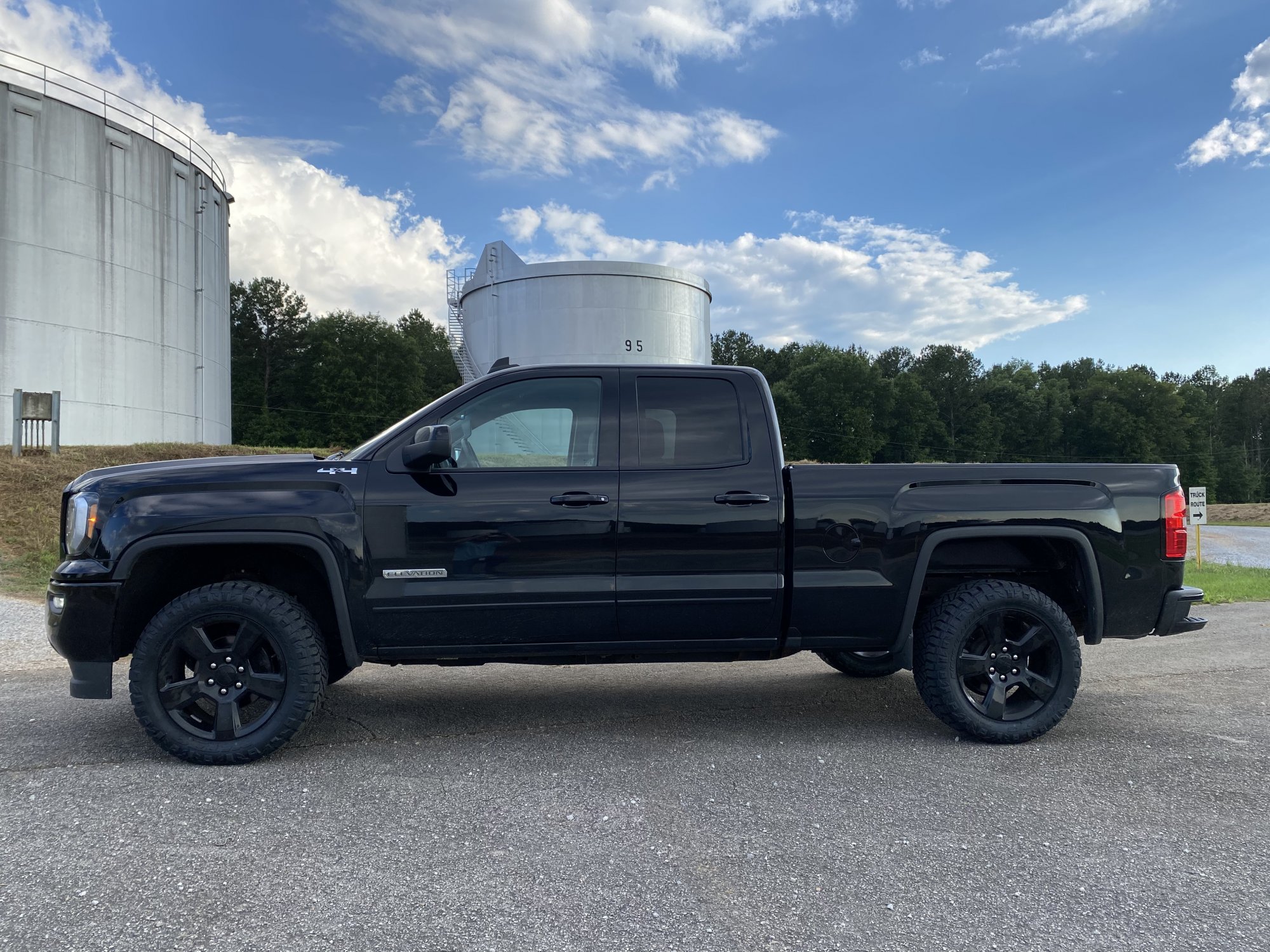

2018 GMC Sierra double cab, 4x4 elevation. I put a 2” rough country level on the front and
275 55r20 (stock size) Nitto Ridge Grappler tires on. I didn’t want to get crazy with mods while the truck is under warranty and I’m happy with how it looks!
