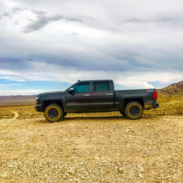

Used Bilsteins for 1.8" up front coupled with 275/60/20 Dura Tracs on my stock rims, really happy with the ride, MPG's with the cruise set at 88mph was terrible though....IMG_6432.thumb.jpg.1d73d84f23114695ca76405cc6f6d67c.jpg
Surely you expected crappy mileage though, right?  If you increased the tire size the speedo is off so you were doing well in excess of 90 MPH.  The leveling also raised the front end so now you have more air going underneath, which means more turbulence.  Couple that with a vehicle as aerodynamic as a cinder block and mileage is going to be in the toilet.
yeah I had low expectations, it was just worse than expected.  I used GPS so the cruise was set at an honest 88 and calculated the MPG manually using the NAV.  I knew the level and 33's wasn't going to help it any LOL!  I just bought this truck to replace my trusty 06' Silverado SS (2wd), it would get 17mpg driving it hard through the mountains....different animal though..
Good looking truck... what are the specs on the level kit and tires/wheels?
Looks like you do use it off-roading, did you replace the factory upper control arm or keep it stock?
It’s a stage 5 Icon suspension set at about 2” of loft in the front. 17” procomp wheels. 33” ko2’s.
  • Like 3

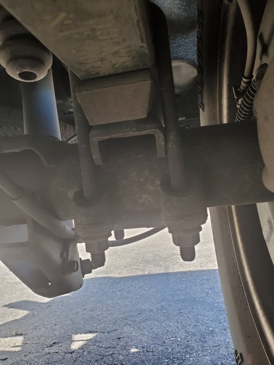

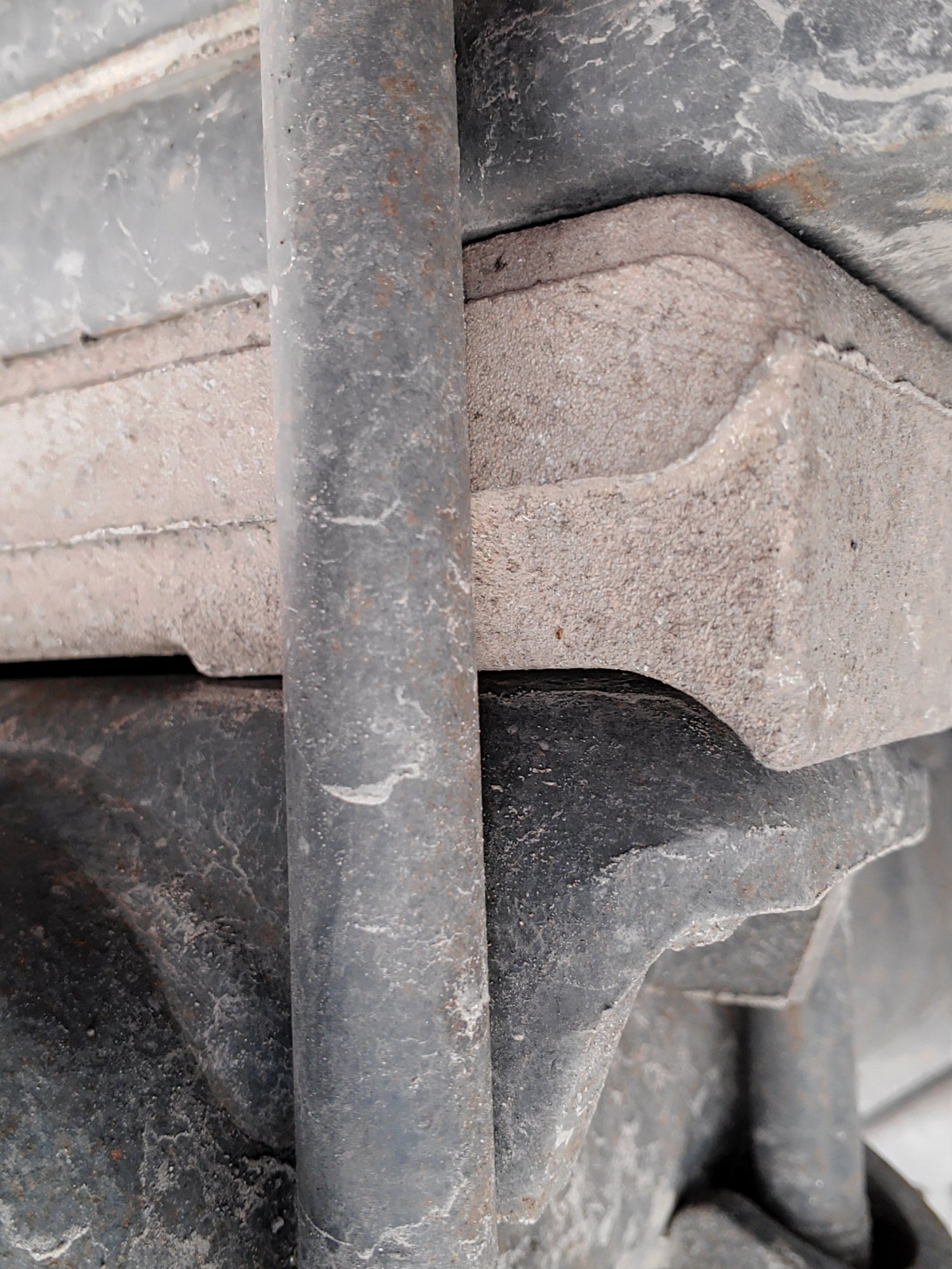

I am looking at leveling my 2015 Silverado.  I was initially thinking of a 2" spacer in front, but then was considering going with 1.5 due to concerns with the truck squatting with any sort of load in the back.  I've been reading up on things online and now I wonder if my rear is sitting lower than normal.  Measured from the ground to the center of the wheel well lip, my front is at about 36.25" and the rear is at about 38.375". (This is with 265/70r17 tires).  Is this normal or could there be something up?  Looks like the stock block is still in there (didn't get a chance to measure, though).  See the image below.

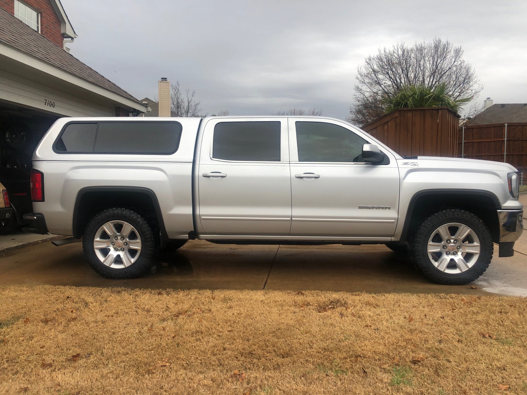

Also, here's pic of my truck this last weekend with a typical weekend getaway load for us.  It certainly doesn't look like this every day, but it's often enough that I don't want my truck to squat when I do it.  I actually measured when we got home, and the rear was about 1" lower than when unloaded.  The cost to add a rear block isn't much componenet-wise, but I've gotta pay someone to install and it doubles the installation costs...
