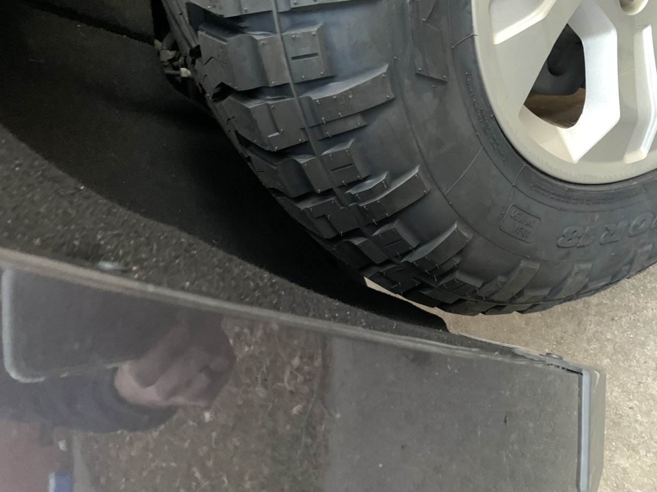

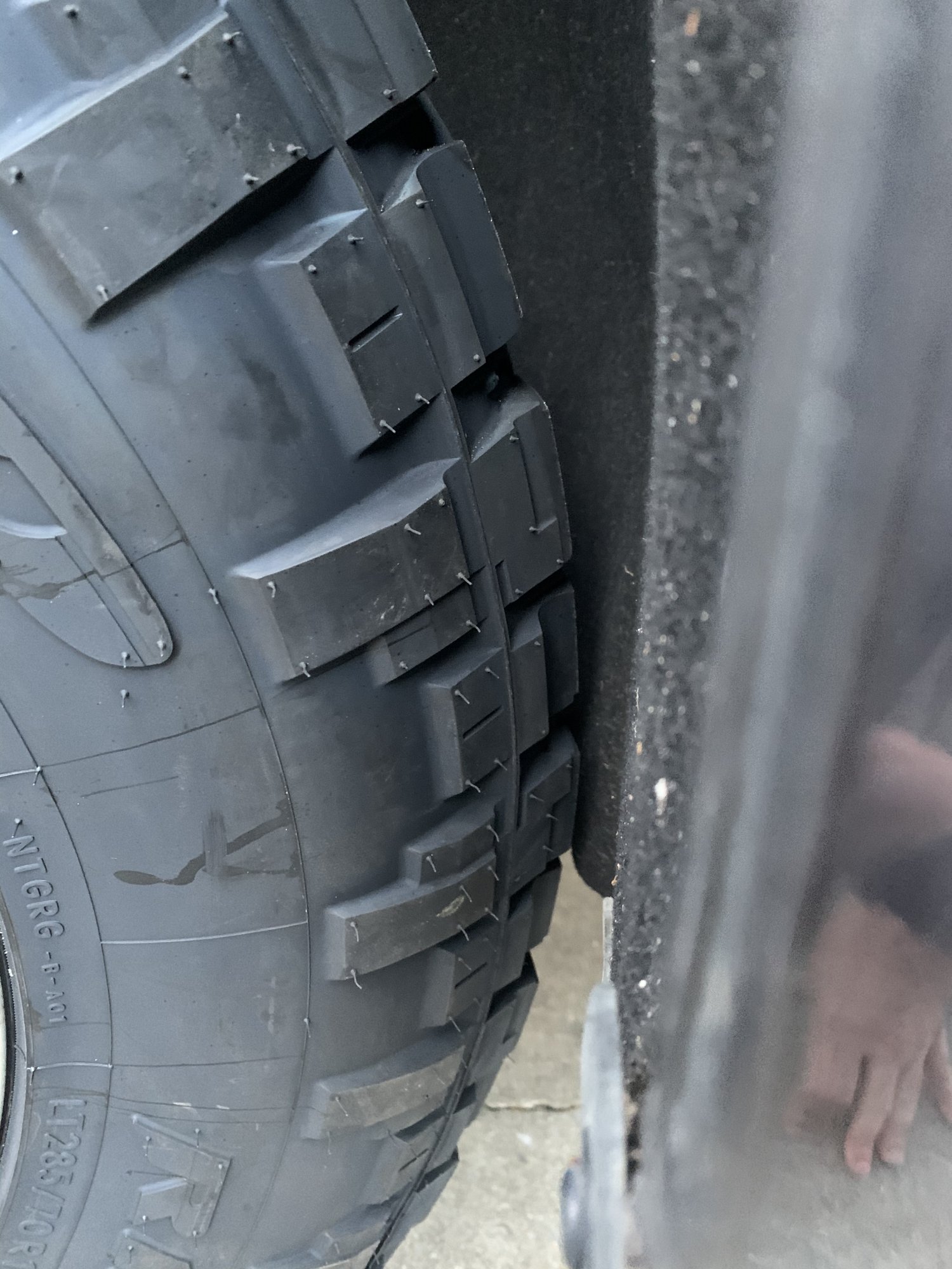

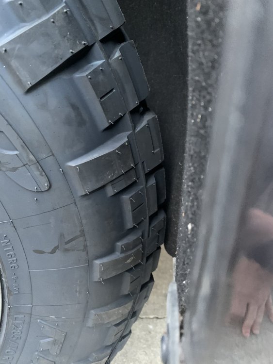

Here’s to all y’all that said 285/70/18 would rub with a 2” RC leveling kit. Well I’m here to tell you they don’t but lord have mercy it’s close.
Dang, you really wanted everyone to see this by posting in 10 different threads!
Looks good -- nice and beefy, but your definition of "fit" might be limited to level straight pavement running.   At full lock with any kind of suspension compression, they are going to hit.  May just rub a little, or may catch the liner and start shredding it.    Looks like a tire more suited for a 4" lift than a level.    Glad you posted this because it confirms that my 285/65/R18s are the biggest I can run on my 2.5 level 2014 Sierra based on the way I use my truck.
is that the front or rear?  have a hard time believing it wont rub at full lock...but if it doesnt and you can drive it, good on you.  little too close for my taste.
That’s the front at full lock to the left. Had these a couple weeks now and still no rub. Here’s a better view.
