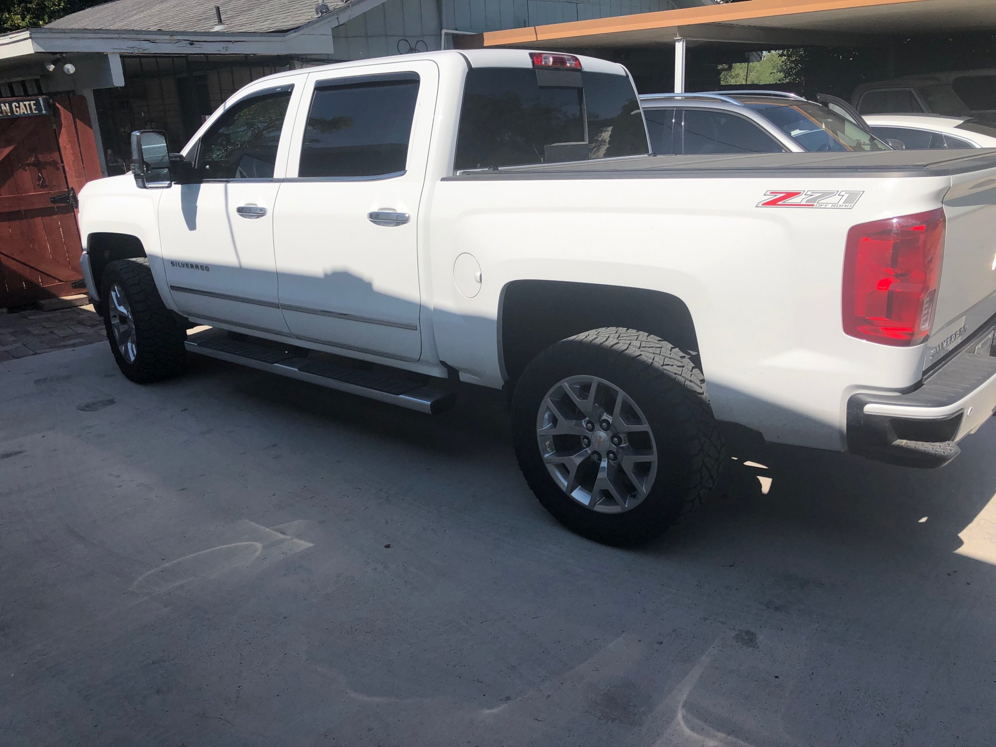

Worked on my dads truck this weekend, here it is completed:
2016 Silverado LTZ Z71 (Cast Steel control arms)
2” Rough Country leveling kit
2” Lift block and U bolts out back
295/55r20 Nitto Ridge Grapplers
Factory Snowflake wheels
Bora 1.25” spacers all around
I need to clean it up and get better pictures.
Edited by pewterliftedz

Well done ! I love the wheel spacers , did you have to do any cutting ?
Do you  have any rubbing ?

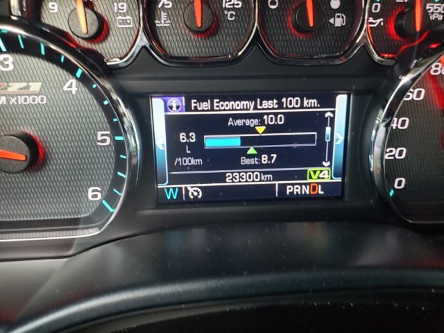

.. just for anyone concerned about mileage impact from leveling with oem tires..I have put around 500km since level with zero negative impact to my fuel mileage.
Hmm, what kind of driving is that? 2 inches higher in the air will impact highway mpg. I did a test with and without the air dam at 75 mph over a 30 mile loop and lost 1.3 mpg. Even having the air dam on more air is hitting the axle, control arms and anything else hanging lower now being higher 2 inches in front. I can see mostly city not having an impact but not highway.

75% of my daily driving is 110-130kph (or around 70-80 mph).. to date I've put around 4000 km on truck since installing the struts
Tyler
You generally ALLWAYS see mpg loss on all leveled truck due to the change of wheel and tires usually because of being wider or heavier and not totally due to a 2” height difference

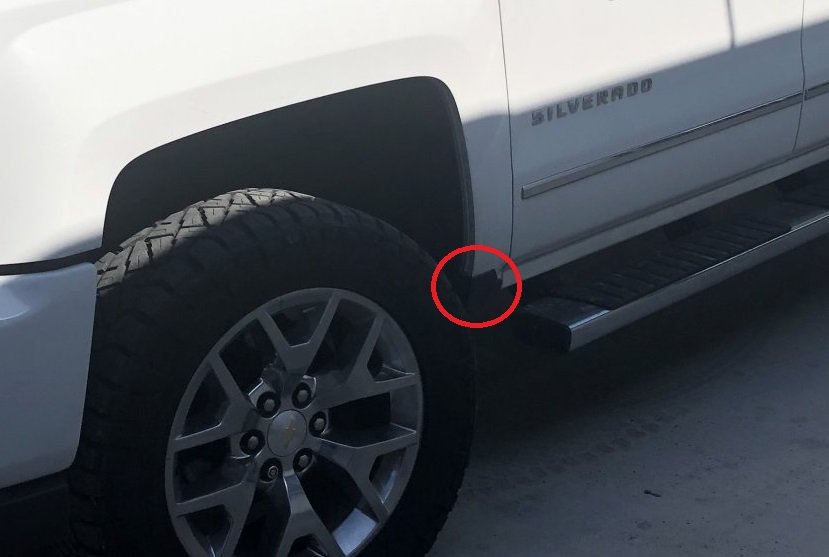

On the passenger side while in reverse, we had some light rubbing on the little rear corner plastic.  I just pulled it off and trimmed it down where it was rubbing, and its all good now.  It's the perfect stance IMO.
A huge plus is that before the spacers, the 295 tires were rubbing on the sway bar at full lock in both directions.  The Bora spacers completely took care of that, and now 0 rubbing issues.

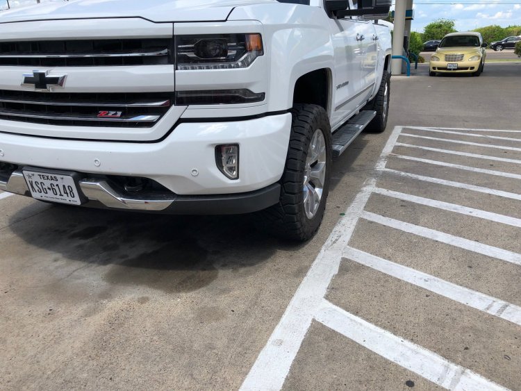

I’ve referenced this thread a lot over the years for multiple trucks so thought I’d come back and give something back when I had the chance:
I had Bilstein 5100s at highest setting and ReadyLift rear +1”s installed 2 years ago by GM dealer. Angles seem fine. There was a point early on where I thought I was feeling some new slight vibrations, but I tend to be overly paranoid about stuff and all has been totally good for about 20,000.
Finally pulled the trigger this weekend on Duratrac 275/60R20s. They fill up the wheel wells a LITTLE more than I anticipated, but fortunately I like the bigger tire look over the lifted/high clearance look anyway.
No signs at all of rubbing after first 100mi. I also have gatorbacks as you can see from the pic, and those eat up some space as well. We’ll see if it’s completely rub-free after a round of towing or two-tracking. If so, zip-ties should take care of it.

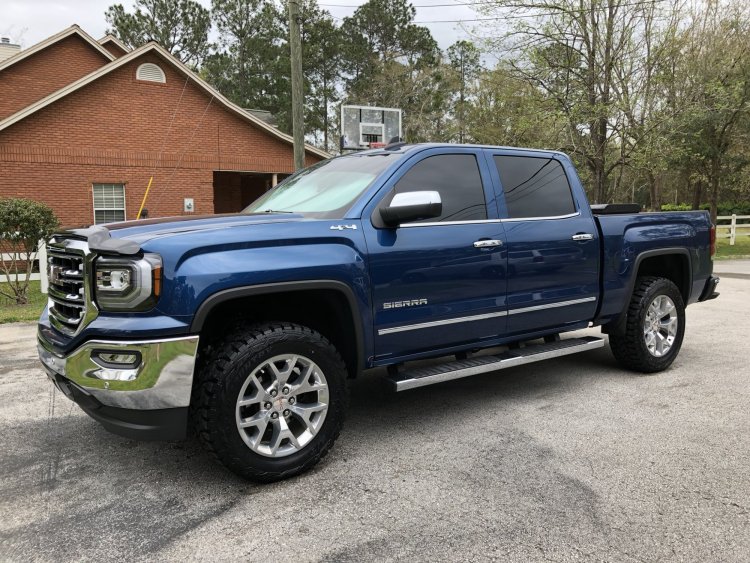

Added new tires to mine yesterday.  Was running the 275/65/20 Michelins that came off our farm truck when we bought it.  Ran them into the ground and was looking for an AT.  Decided on Ironman All Country AT.. $527 delivered to my tire guy, and $30 to mount and balance the 4.  So, $557 total and they ride like a dream.  Seen nothing but great reviews on them, so we will see how they work for me!
Truck has a 2.5" level, 275/65/20 Ironman AT tires, and AMP steps.  Painting the back bumper and wrapping the front one to match, next.
