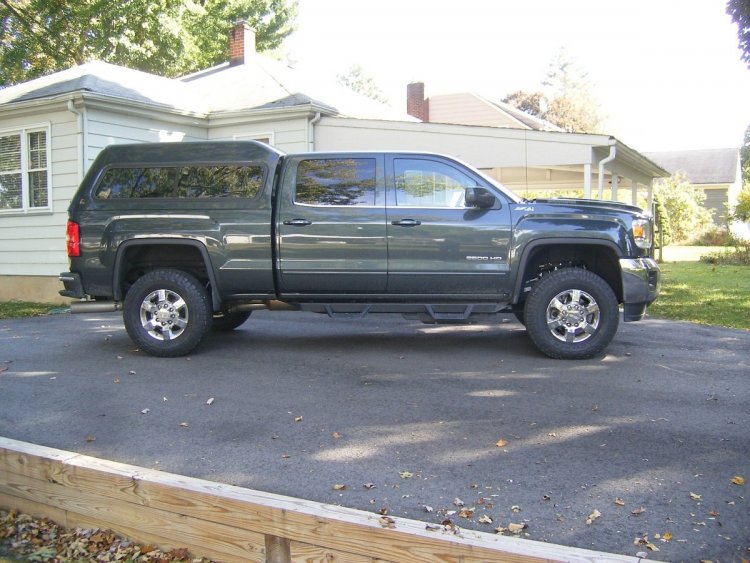

It's finally my turn to have something to post in this thread.
RC 2" Leveling Kit
Fox Performance 2.0 Shocks
Cooper Discoverer AT3 XLT  285-75R18

Good looking truck, how do you like the Cooper XLT and what are your initial thoughts on them?

So far, so good.  I have almost 600 miles on them now but that's all been in the dry; for whatever reason, when it's rained in NJ I've either been working from home that day or it was a weekend and I wasn't heading out.  My research suggests they're good in the rain but I don't know myself yet.  Looking at the number of wheel weights it seems like they might have been a challenge to balance, but they ride good.  I get a little hum that starts about 40 but by 50-55 the road and wind noise drowns it out.
I wish I could tell you how much of the ride difference is due to the tires and how much is the shocks but unfortunately I can't.  Fox told me not to put on the front ones until I did the leveling because they would likely bottom out so tires and shocks were done at the same time.  I can tell you the combination makes the truck so much more stable going over rough roads.  The factory Rancho's seemed to lack sufficient damping so ruts and uneven surfaces - especially on the highway - would unsettle the truck.  The suspension movements were very sharp and exaggerated.  There's one patch on my commute home that really used to be a white-knuckle affair.  It's a slight bend in the road with a bridge and a dip on the left side (the right side has no dip).  With the original Rancho's and Michelin's the truck would become difficult to keep in the lane as you hit the expansion joints and that dip during the curve, even if you were only going 70.  Now, at 75 the truck barely reacts. For me that's a huge update, there's no more WTF moment when I get to that area.
One thing I do notice though is more back-and-forth wobble in the steering wheel when hitting bumps and potholes.  The truck did that before but with the bigger/heavier tires and firmer shocks it's now pretty obvious.  A steering stabilizer is in my future.  For me that's an acceptable trade-off for what I gained.

You did do an alignment after the level, hopefully
