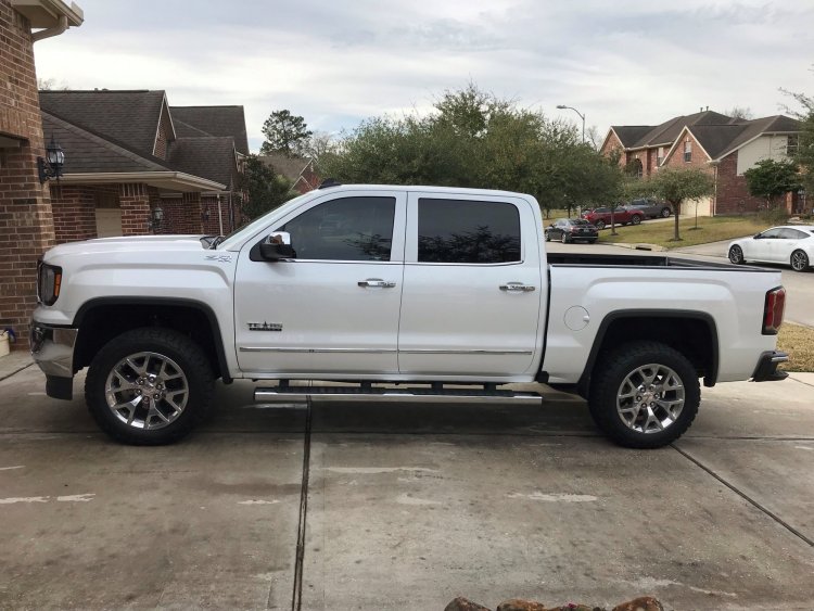

This is just my opinion but if you go larger than 285/55/20 or 275/60/20 you may have some rubbing issues with stock wheels or need to use a .25 inch spacer to keep from rubbing.  What I did was install the Bilstein 5100 struts in front with a spacer to level the front, and some 5100s in back.  Truck sits close to level and ride quality is much better with the Bilsteins as compared to the OEM Ranchos that came as part of the Z71 package.  Ride is much more controlled and not as mushy, in my opinion.  And the 275/60/20 BFG All Terrain T/A KO2s are not noisy and my MPG has not changed much from when it was stock.  Plus I can still get into all the parking garages in Houston.

Which setting did you set the Bilsteins? And how big of a spacer did you get for the strut? My concern is for the angles as well I don’t want to mess with the ball joints. If I don’t need to purchase new upper a arms I rather not. And my thought as well was to go get some BFG’s. Do you have a pic of your set up?

I left the Bilstein struts on the lowest/stock setting and installed a Rugged Off Road spacer to bring it up 1.85"-2" in the front.  My angles are fine with this setup and I kept the stock UCAs.
https://www.ruggedoffroad.com/product-page/2007-2017-chevy-silverado-gmc-sierra-1500-6-lug-2-0-leveling-kit

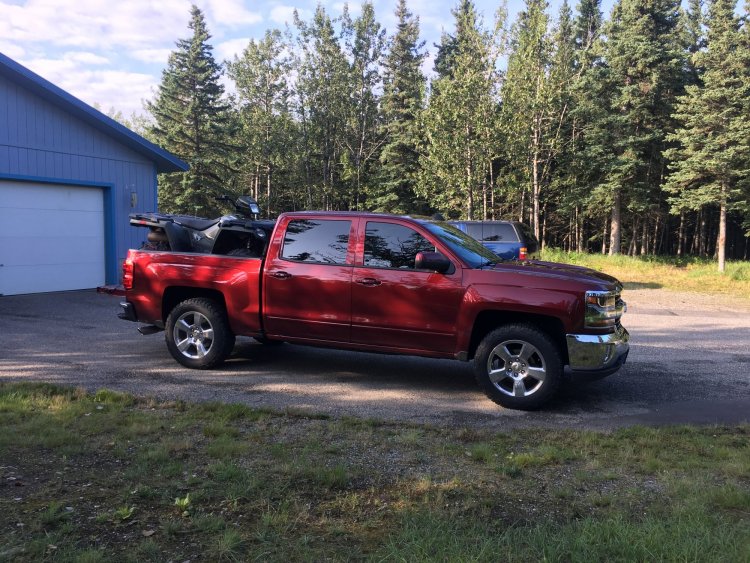

26 minutes ago, bndawgs said:
Is anyone running 275/60/20 BFGs All Terrains on their stock setup?
I am, I think it looks great! No rubbing or clearance issues, been on the truck for 12k+ miles, completely stock. I load up with ATVs and firewood regularly and have no problems, you will notice the weight though... I lost a solid 3mpgs with the 20s and BFG KO2s.604.thumb.JPG.c92d37725944496266f5e7806182ec98.JPG
