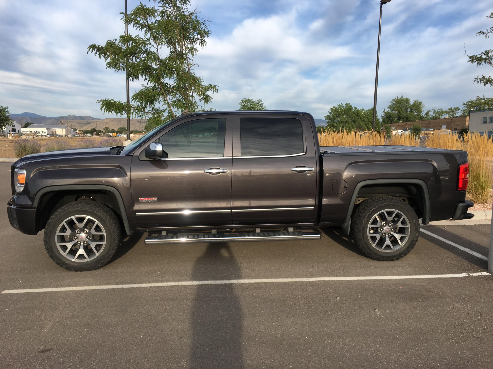

Hey Guys, I posted here almost 4 years ago after putting a 2.25" leveling block on my 14 sierra all terrain, wanted to give an update.
I put the ProComp 2.25" block up front (nothing else) at roughly 25k miles, and at about 55k miles my upper ball joints were shot. Not sure exactly why, but would have to assume its from the additional length the spacer added  to the shocks, putting the upper control arm out of its operating range.  So I got new upper control arms (not sure what part number shop just got me new ones) that are suppose to accommodate a 2-4" lift. Since then, no issues.
At 64k my tie-rods were shot as well, had to replace those. While the truck was in the shop, I had them replace the dog shit stock rancho shocks and remove the 2.25" spacer and just use Bilstein 5100, raised about 1.75". The front dropped about 0.5" inch as expected since the bilsteins at one setting below highest are shorter than the ranchos plus spacer.
The truck has a slight rake now. Before with the 2.25" spacer, it was dead level. I a running 275/60/20 KO2s, they cleared no problem with the 2.25". Even now with the bilsteins, no issues with rubbing at all. Will for sure go wider tires next, maybe slightly taller too. ( i plan on going 17s with 0 offset).
The ride is MUCH better than those ranchos, especially after 64k miles. The ride is still firm but the rebound and compliance of the truck now is so much better. Only had the bilsteins 5100 (front and rear) on for a week now, but the ride difference was immediately apparent. Its most noticeable when you push the suspension a bit. Riding down the hwy on a smooth road isn't that different, but when you hit a bump/break in the road/dip, is when you really notice it. The initial impact is still hard, but with the ranchos the truck would literally bounce off the ground, with these bilsteins it comes right back to where it should be. Should have done this right when i bought the truck.
2018 GMC All Terrain
Bilstien 5100s all around (front at highest setting)
Stock blocks in back
Stock Stamped UCAs
295 55 20 Ridge Grapplers
No Spacers
Minimum Rubbing at FULL lock on UCA
