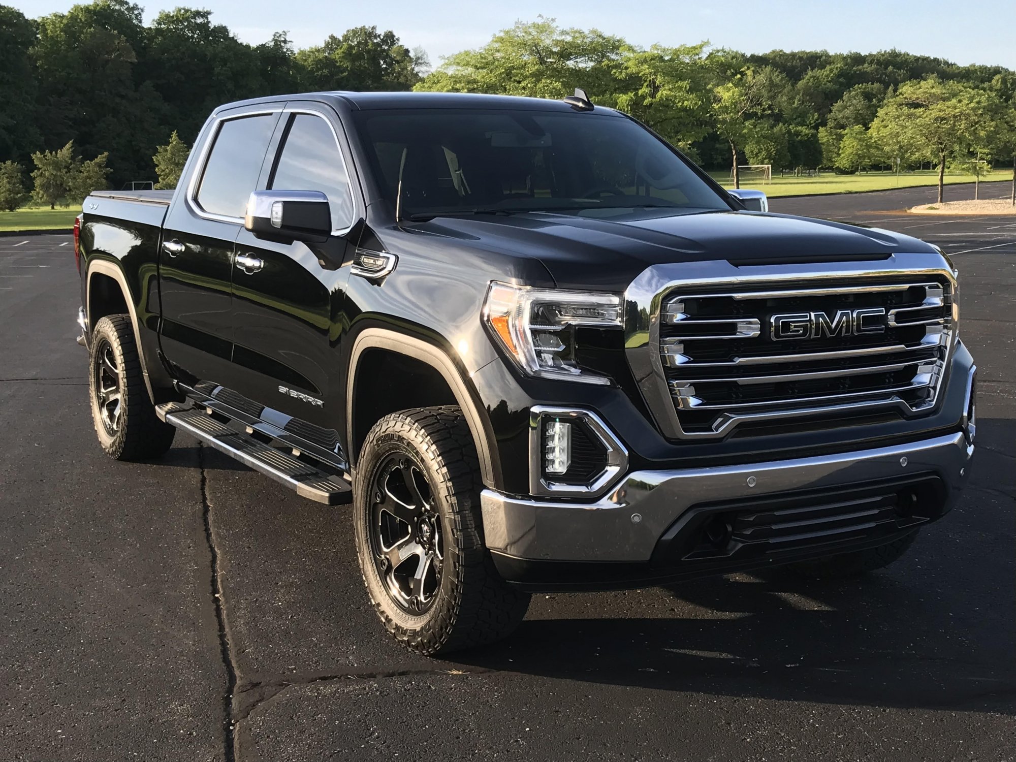

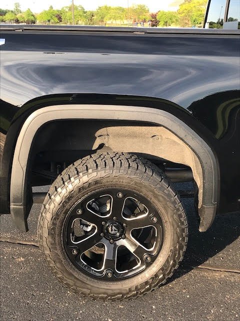

I recently upgraded from my 2017 Sierra 1500 SLT to a 2019 Sierra 1500 SLT.  So of course I did my usual upgrades: window tint, spray-in bedliner, 2.5" level kit and Fuel Beast 20" wheels with 305/55R20 rubber.  I did the level kit(s) over the weekend and put the new wheels and tires on.  I think it looks much better now.  I just left Belle Tire getting the front end re-aligned, so I should be good to go.  I do have a slight tire rub at full lock at the rear of the wheel well, so I'll have to trim back the plastic/carpet in that area.  Other than that, it looks great.  The level kit was a Motofab 2.5" in the front, and a Motofab 1" in the rear.  For some reason, the 1" in the rear gave me a lot more than that though.
Prior to the leveling kits, my front height (ground to bottom of fender flare) was 36.875" and my rear height was 38".50".  After the leveling kit, my front height is now 39.50 (increase of 2.625") and the rear height is 40.75" (increase of 2.25")
What did you do with your stock wheels? Looks great, BTW.
My Dad put my wheels and tires on his 17’ Silverado. He had plain Jane wheels on it before.

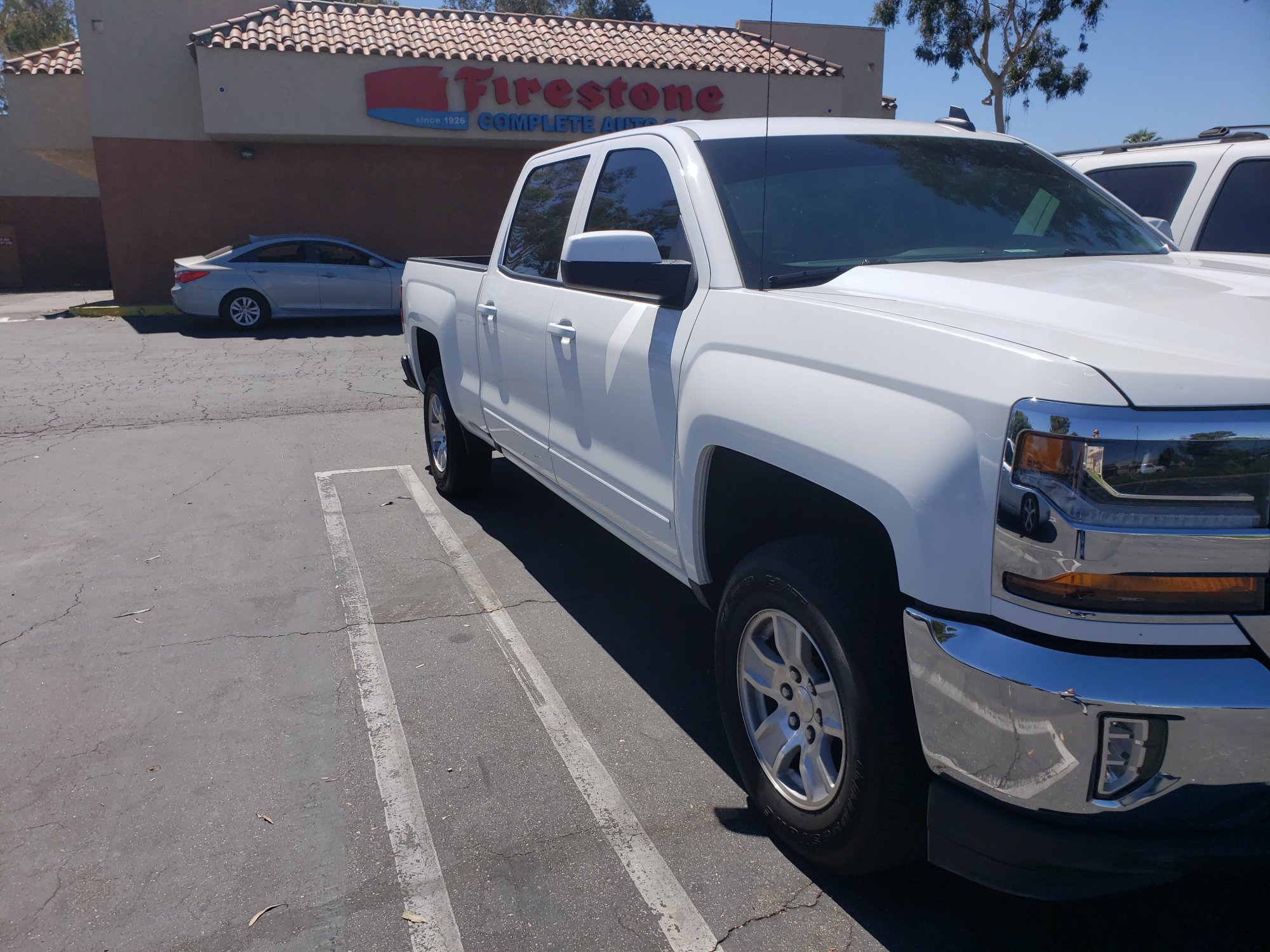

So I’ve read through quite a bit of this thread, even as long as it is. Can anyone be a little more specific on this question?
I have a 17 Silverado 4wd that I want to level (2”) and put 285/55/20’s all terrain tires. What kind of mileage drop am I looking at if I get between 18-22 on hwy currently?
Also, what kind of ride change should I expect?
Best answer, it depends. There's a lot of variables in play, especially the type of tread on the all-terrain tires, what ply and how heavy they are. I had 305/55/20's on a RC leveling kit and had 285/55/20's on Bilstein adjustable shocks set at max level and got about 15/18 city/hwy and now I have a 5" RC bracket suspension lift on the 285/55/20's. You also have to consider what type of driver you are, i.e. feather the throttle or drive it like you stole it. I am in-between as there are times when I want to hear the engine/exhaust roar like a lion or having to just get the heck out of the way of idiot drivers.  All-in-all, I would say just a few mpg, more if you tow a lot also. The ride will get a little stiffer as you're changing the geometry of the suspension, to where it doesn't have as much room to move and take the brunt of the bumps and holes.  I hope it helps and good luck on your decision.
