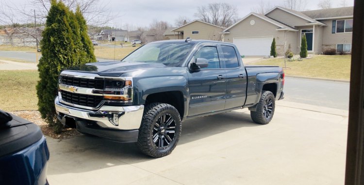

Running a 2018 Silverado 2.5 MotoFab leveling kit w/ready lift upper control arms on 20x9 Moto Metal Rims and 33’’ nittos. No rubbing at full lock.

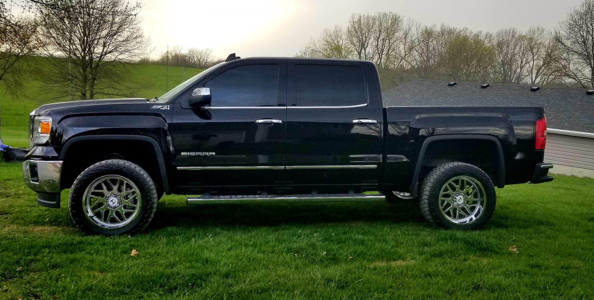

I am running 285/60 R20 Toyo Open Country RT with a 2 1/2 leveling kit and I had to add the RC 1/4 spacers behind the stock snowflake wheels on my 2018 GMC to stop the rubbing on both the UC Arm and the sway bar.
