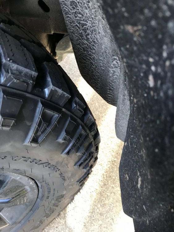

I installed Eibach pro-truck lifted springs in the front set at 2.5 inches with an add-a-leaf in the rear on my '15 half-ton. Just put on 295/65r18 Duratracs on stock z71 wheels yesterday and it sits 39.75 inches front and 41.25 inches rear which is perfect for towing a trailer and having the truck sit level instead of rear sag. Here are some photos of the front wheel well at full turn with no rubbing whatsoever. I'll have more photos of the truck soon but I need to wash her first. This is my first ever post and have spent MONTHS researching leveling kits, lift kits, and tire size on these forums so i'd like to say thank you to you all!

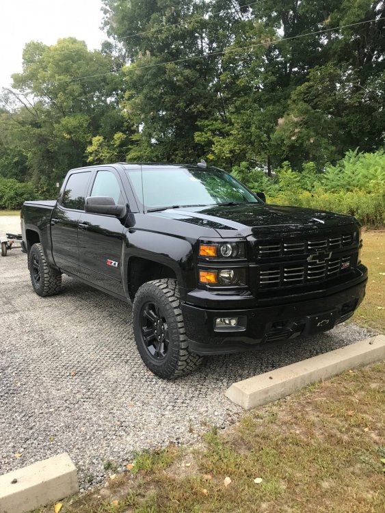

2015 LTZ Midnight Edition with Eibach Pro Truck Kit set at 2.5in level with BDS add-a-leaf springs (just go to your local spring shop and have them add another leaf, don't bother buying the short BDS ones like I did) sitting on 295/65r18 Duratracs on stock wheels.
