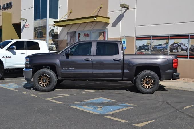

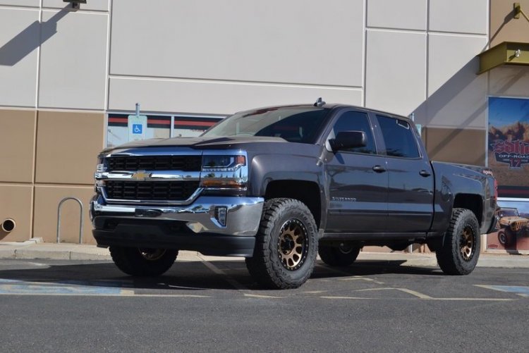

I found a picture from SDHQ’s website. Saw you have their skid plates. Pretty badass! Love the Bronze wheel look too. I’ll post pictures of mine once I finish installing everything.
How many miles do you have on your Coopers? And how have they been off-road for you?
Nice! Probably have under 1k miles on the coopers and haven’t had them Offroad so can’t comment on that yet. On road though they are nice and quiet

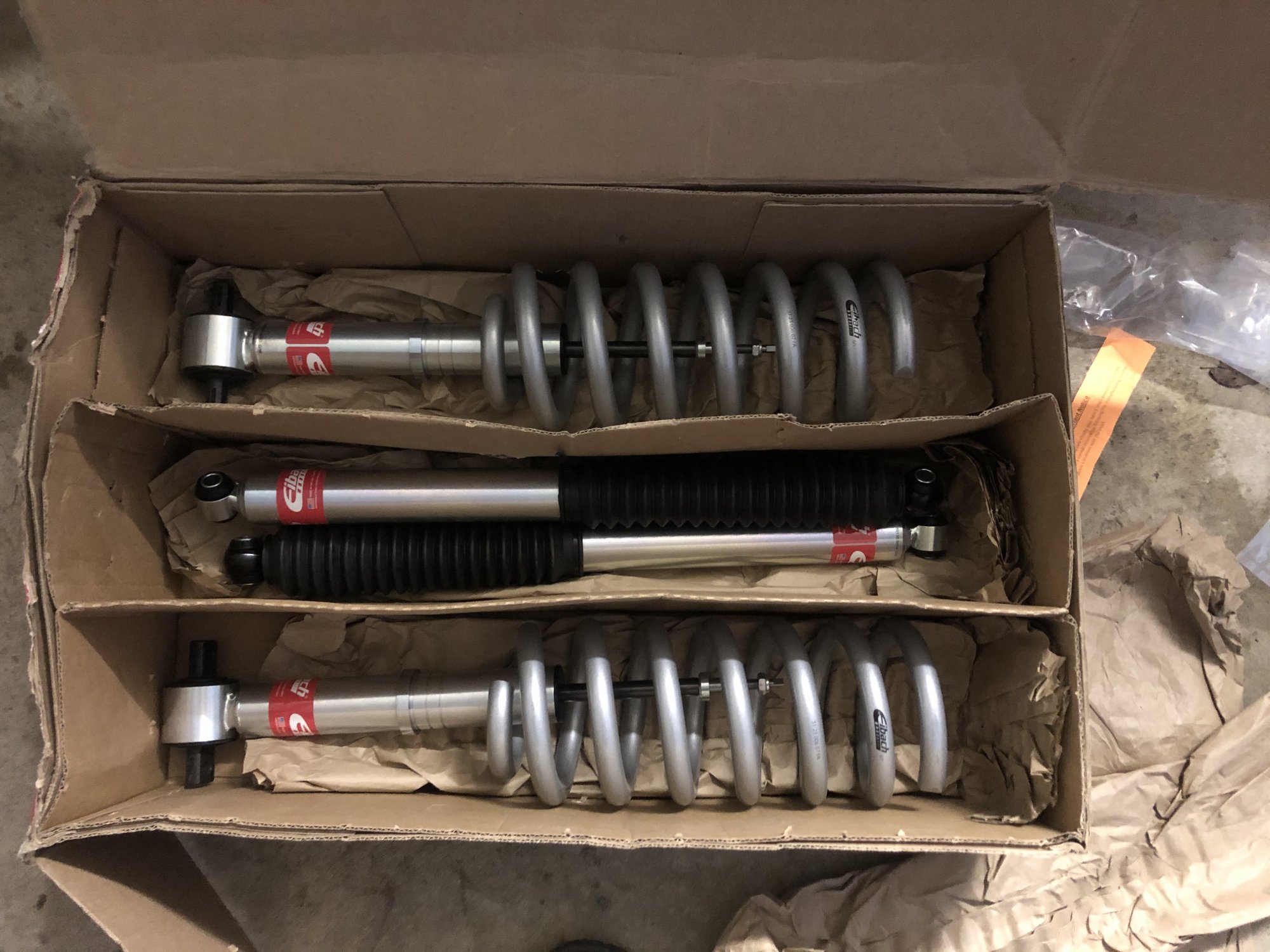

This showed up today. Probably wait for warmer weather to install them. Also got some Motofab 2” blocks for the rear. I’m gonna run the stock UCA for now and probably buy aftermarket arms when the upper ball joints wear out. My 2016 has the aluminum control arms.
