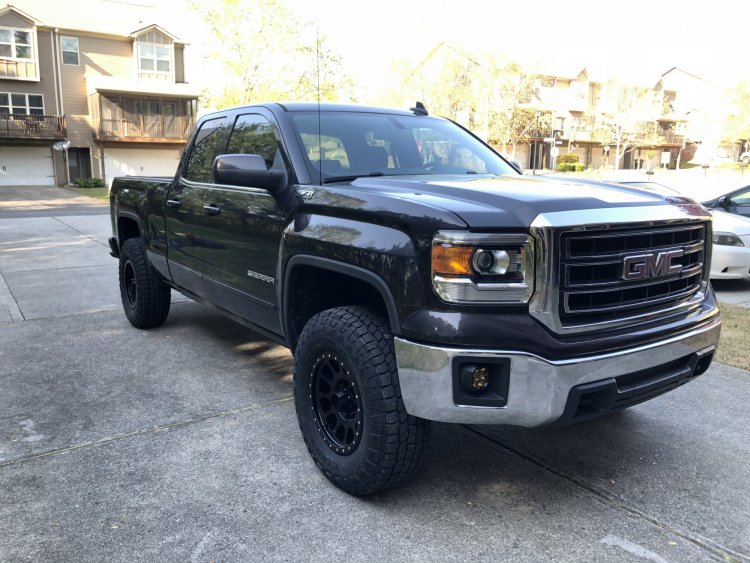

Just finished everything up. Running an Eibach pro truck lift with Dirt King Fab upper control arms. I also upgraded to Moog tie rod ends and sway bar end links. In the rear I swapped the stock 1inch block for a 2inch block. Got 17x8.5 0mm Method NVs on 285/75r17 cooper discoverer XLT. Also did an LED headlight conversion and swapped the fog lights for amber Diode Dynamic pod lights.
let me know if yall have any questions! Turned out pretty good in my opinion.

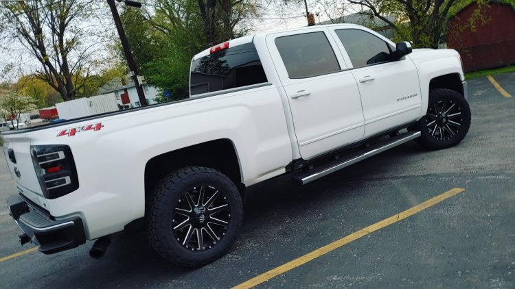

Got a 18 Silverado 5.3  with a rough country 2"  level and 295/55/r20 toyo at3s on 20x9 fuel contra's +19 offset.  Have put about 300 miles on and first impressions is the weight of those toyos definitely slugs her.
Anyway, what I'm interested in is to see if anyone is running a similar set up and actually put some miles on that rc level?  My angles don't look too bad to me but I'm wondering what kind of life ya'll are getting out of the stock suspension components with a 2 inch block and 33's (well not quite)? Ive read a couple guys talking about some pretty extensive repairs at like 20k and just like to see what you guys have to say about it.  I realize I'm in for some accelerated wear and tear but i don't off road much and nothing extreme and only tow a light fishing boat on occasion. Just want to see what im going to be in for a year or two out?

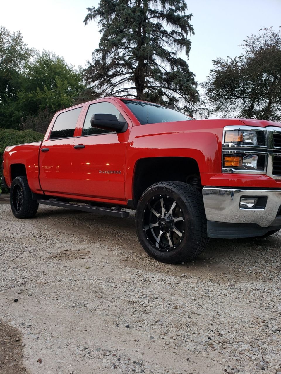

2014 Silverado 1500. 3 inch front leveling kit with 2 inch rear blocks. Rough Country UCA's, new ACDelco tie rod ends and sway bar end links. Installing 1 inch diff drop in a few days.

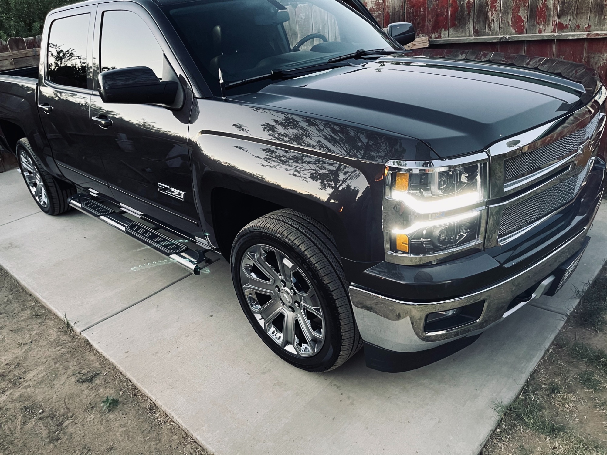

I have a 2015 chevy silverado z71 .I have oem 22’s . Looking for a good leveling kit, what do u guys recomend? Thanks
Just look at the post above yours, and prior posts, you might find many choices?
Welcome to the site.
Good looking truck. Did not know you could use the 16+ headlights with the 14 - 15 grills.
Looks pretty cool!
