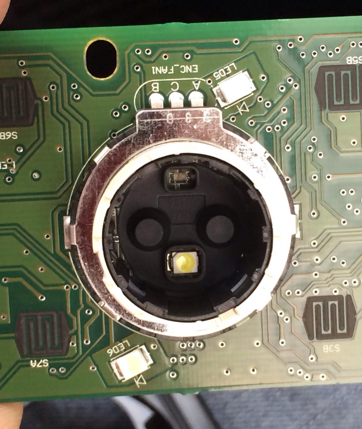

I forgot to do the ac fan knob..kicking my self in the butt...but I did pull thr assembly out.. there are several black clips that hold it in the assembly. Then the white back plastic cover will pop off... I also couldn't figure out how to go any father. . I can't imagine that led is different.. but I don't know. It is two separate circuit boards so you never know.

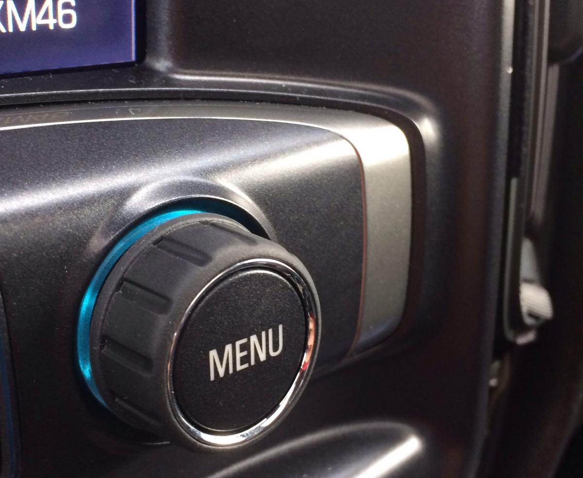

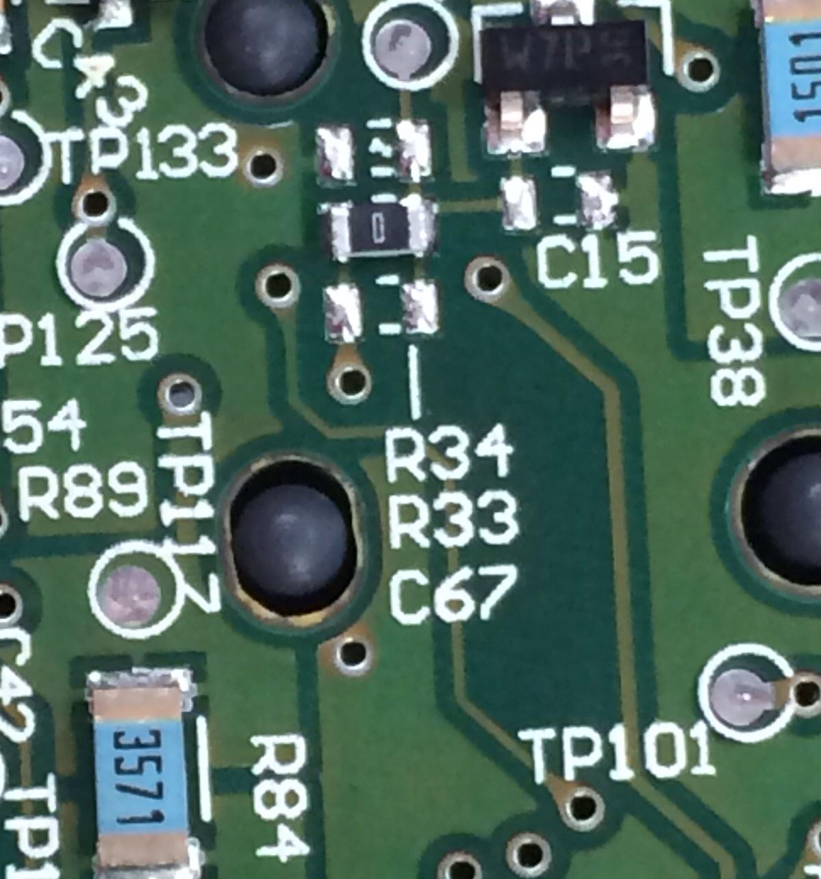

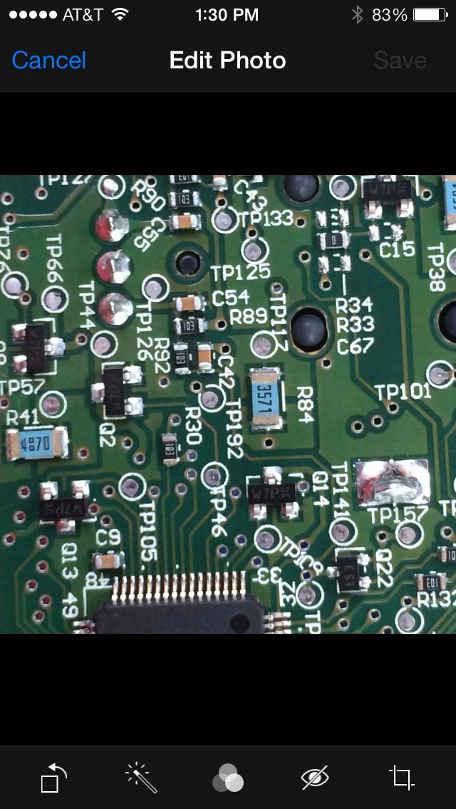

Ok so I got my knob lights working, I used cold solder and it worked just fine. Also, I took apart the a.c. Unit and it was a bitch ! Lol. You have to take off each button to remove the circuit board. Don't be scared it won't break. Then pull the center knob off and everything is right there. However, although the LEDs are there. I can't find the resistor for it! I have no idea which one it is. It's not set up like the radio. The pics will show the only resistors I found missing and who knows maybe it is or now but, I think ima take it to my guy. (R33-R34)post-123522-0-49522600-1386440946_thumb.jpgpost-123522-0-46762300-1386440955_thumb.jpgpost-123522-0-16655100-1386440988_thumb.jpgpost-123522-0-36555700-1386441046_thumb.jpgpost-123522-0-48991000-1386441059_thumb.jpg
Looks to me like it would be r34..? Hmmm
Ok so I got my knob lights working, I used cold solder and it worked just fine. Also, I took apart the a.c. Unit and it was a bitch ! Lol. You have to take off each button to remove the circuit board. Don't be scared it won't break. Then pull the center knob off and everything is right there. However, although the LEDs are there. I can't find the resistor for it! I have no idea which one it is. It's not set up like the radio. The pics will show the only resistors I found missing and who knows maybe it is or now but, I think ima take it to my guy. (R33-R34) image.jpg image.jpg image.jpg image.jpg image.jpg
And that's what I think. I just wanna take it to someone who may know more than me.

I had the ac circuit board out, but couldn't figure out the correct resistor either. Would be nice to compare against a GMC one or someone could trace the led connetions out
Ok so I got my knob lights working, I used cold solder and it worked just fine. Also, I took apart the a.c. Unit and it was a bitch ! Lol. You have to take off each button to remove the circuit board. Don't be scared it won't break. Then pull the center knob off and everything is right there. However, although the LEDs are there. I can't find the resistor for it! I have no idea which one it is. It's not set up like the radio. The pics will show the only resistors I found missing and who knows maybe it is or now but, I think ima take it to my guy. (R33-R34)attachicon.gifimage.jpgattachicon.gifimage.jpgattachicon.gifimage.jpgattachicon.gifimage.jpgattachicon.gifimage.jpg
Do you have a multi meter you can use to trace out the resistor?
I do not, I wouldn't even know where to start to be honest with you.
I didn't take my front knobs off the ac unit so I couldn't see those LEDs, but you cab use a multi meter to check connectivity between the terminals of the led and the open resistor socket..
I checked, and all 5 of my knobs are darked out. GM needs to put a fix out so I can take it in to dealership.
