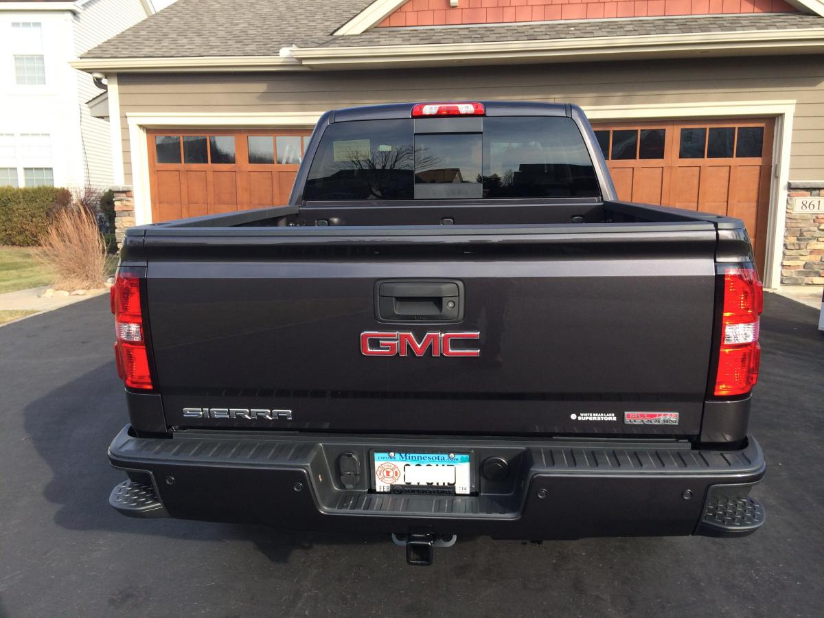

Since this topic was generated specifically about GMC AT I'll add a comment that I posted on my truck thread. My AT showed up yesterday and it had a manufacturer modification. They added steps to the painted bumpers. When i ordered this was not even an option. All the other AT's on the lot had no steps. The painted bumper w/ steps was reserved for the Denali only. For whatever reason they decided to make this standard on the AT also. I love that they did!
