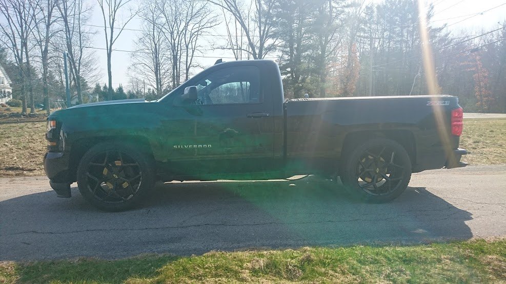

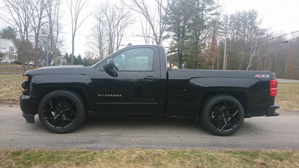

I added this same post to my build thread
So when I originally put the flip kit in I had the rear hangers set at the 6'' position and used my 2'' drop shackles to raise it back up to 5''.  I decided 5'' was low enough in the rear and wanted to to get the drop shackles replaced with the stock shackles, so  lowered the hanger to the 5'' spot and put the factory shackle back in.
Now it in theory it shouldn't have changed the rear drop, since both were set to 5'', but I feel like the truck is sitting an inch higher in not only the back, but also the front now.  I'm pretty sure it's only in my head, and I measured from floor to fender and I'm 34'' front and 35'' rear,  and I could have sworn I was 33"/34" last week.
Either I'm going crazy or now I want it lower, But the front seems awfully high now.  I'll take it out tomorrow and take another side shot pic in the same spot in my driveway as I previously did.
Here's how it sits now:
Edited by qwank
  • Thanks 1
I guess it's all in my head, It seems to be the same.  I made sure to tilt the camera up this time so it didn't look like I was going uphill.
trucksun.thumb.JPG.40e8ac7c69c6eb62f13ee7cc5cfde783.JPGtrucck2.thumb.jpg.3dc0386046a59e20456a3b8adc1dd58c.jpg
Edited by qwank
3/5?    Front looks like 4
 it should be 4, but it only dropped an inch after I installed the spindles according to my measurements,  but they could be wrong.  only matters what it looks like I guess.
