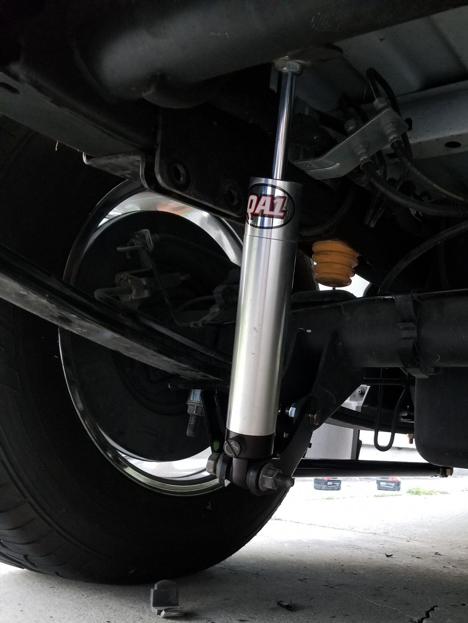

What shocks do you have. Change the shocks to some adjustables and you might be ok.  Because you should be fine at 8" with a c notch.   Hoping you're a regular cab though
Belltech Street Perfomance on a double cab. That extra 500 pounds makes a bigger difference than I thought it would.
I forget...did you end up with Vikings or QA1's?
Qa1 in the rear. Which made a huge difference. And Vikings are being installed in the front after the rain stops
