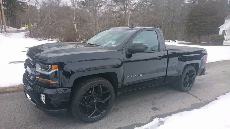

7 minutes ago, Nasty said:
Qa1 in the rear. Which made a huge difference. And Vikings are being installed in the front after the rain stops
I'm gonna have to jump under there and see where my stops sit compared to yours. I didn't think the Belltechs were that soft, but now I need to consider alternatives. Helpers definitely wouldn't hurt either.
Now that it's down, going back up isn't really all that fun.
Well if you're notched. You should be fine. I don't think you're hitting the frame. I think your diff is slamming the bed support.  I hit the bed support before I hit the frame and I'm not even notched
Tighter radius than a lot of cars. Lol.
Nice video.
Still drives like stock, if not better.
Not too shabby for a half assed video shot from my phone lol
Sent from my SM-N950U using Tapatalk
I'm down to 2/5 now.  the front is 1/2" higher than the rear.  My drop spindles will be in next week.
I,think it's level. The rear fenders are actually lower than the front. If that's how you're measuring
Looks great man. Mine 2/4 but I want my back lower.

So what's the difference between a 6.5 and 8" rear drop? An axle that no longer aligns with the notch.
Yeah, I'm kinda frustrated.
It should align just fine    are you having issues ?
The slight change in angle of the leaf places the axle slightly further forward when the suspension is under load, and it no longer lines up with the notch. Axle is hitting the frame right where the notch begins.
The notch also may not have been perfectly centered to begin with.
Edited by Stressin
1 minute ago, Stressin said:
The slight change in angle of the leaf places the axle slightly further forward when the suspension is under load, and it no longer lines up with the notch. The notch also may not have been perfectly centered to begin with.
What notch?
12 minutes ago, Nasty said:
What notch?
Street Edge (bolt-on). Belltech's were backordered.
Edited by Stressin
