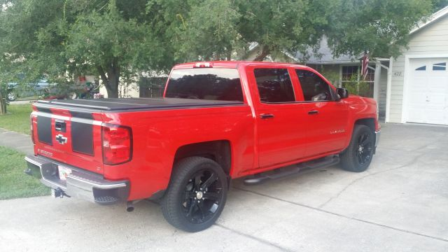

Can't answer the Magride question but I can share the picture below of what it looks like after the drop shackles.  Not straight on but it gives you an idea.
This is from a different angle but it gives an idea of how high the back used to sit.

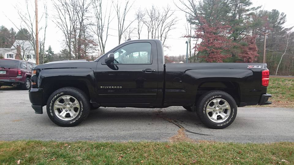

Just a shackle should make the angle better I think.  I don't have magride but lowering my truck made the drivelune angle better
Here's my truck when it just had  the blocks in the back removed. Front is stock height.
Edited by qwank
This is mine with the lowering shackles installed and blocks removed.
