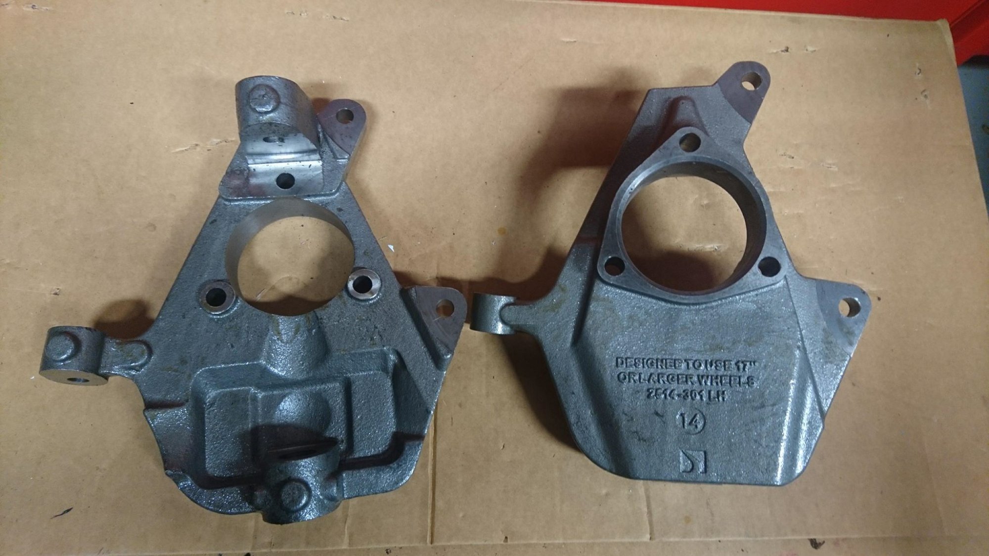

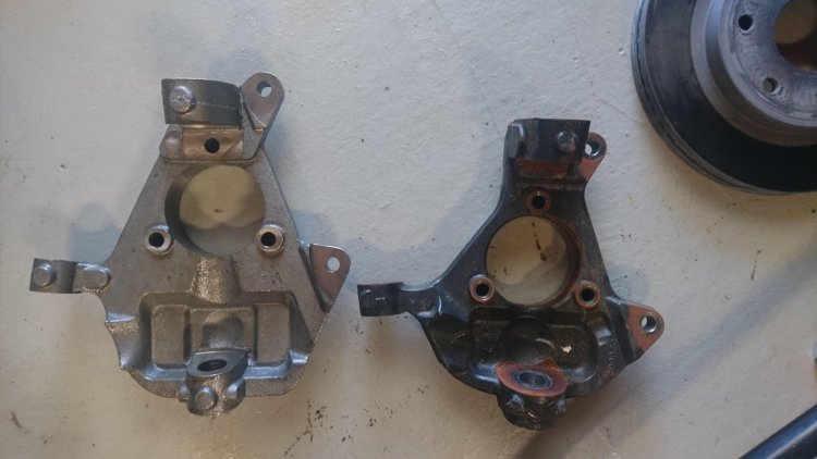

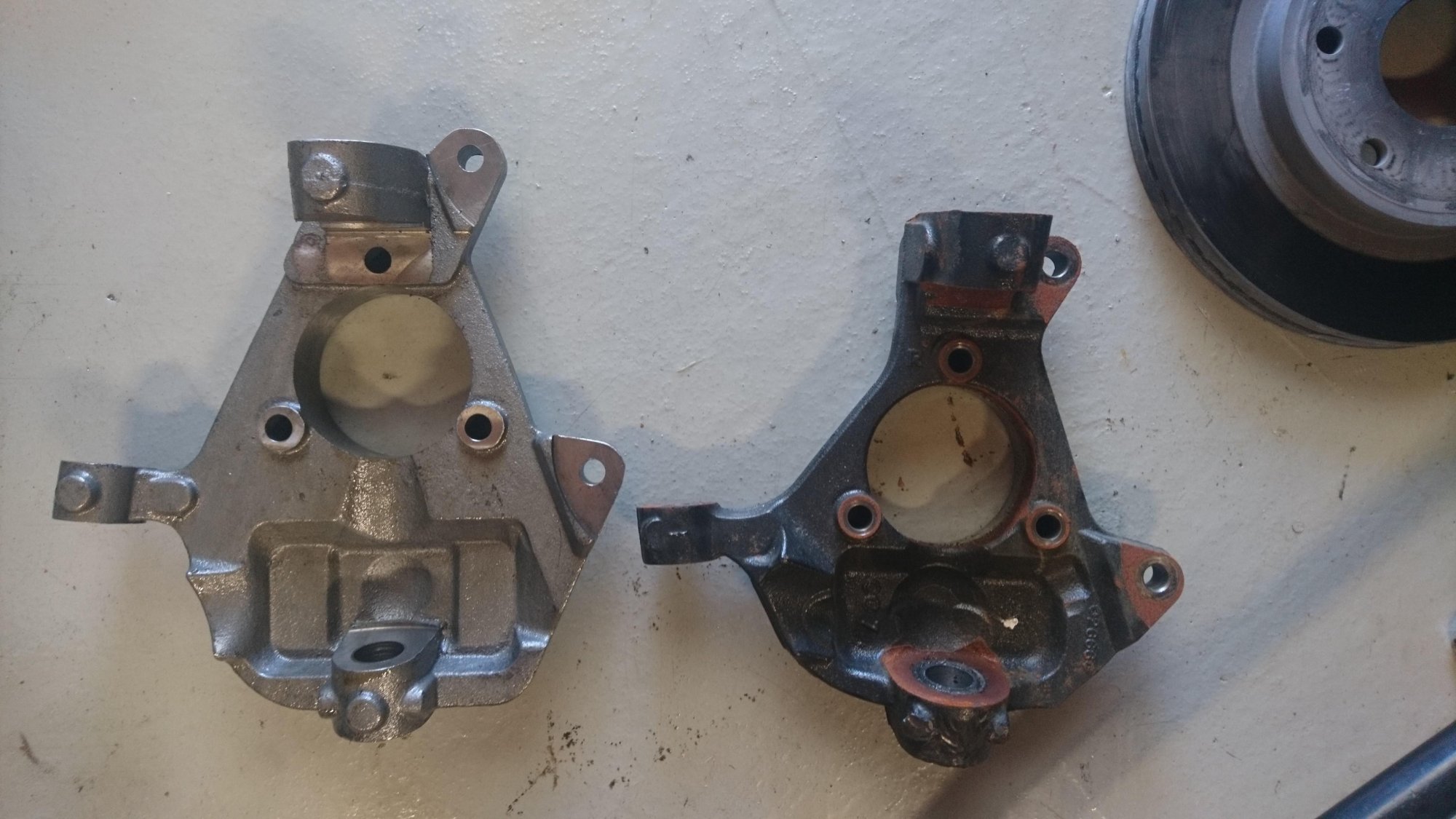

Bell tech drop spindles now in. I'm also using drop struts at the 2'' setting.
Here's some pics of the spindles since there's not much about them online
Compared to the stock spindle
