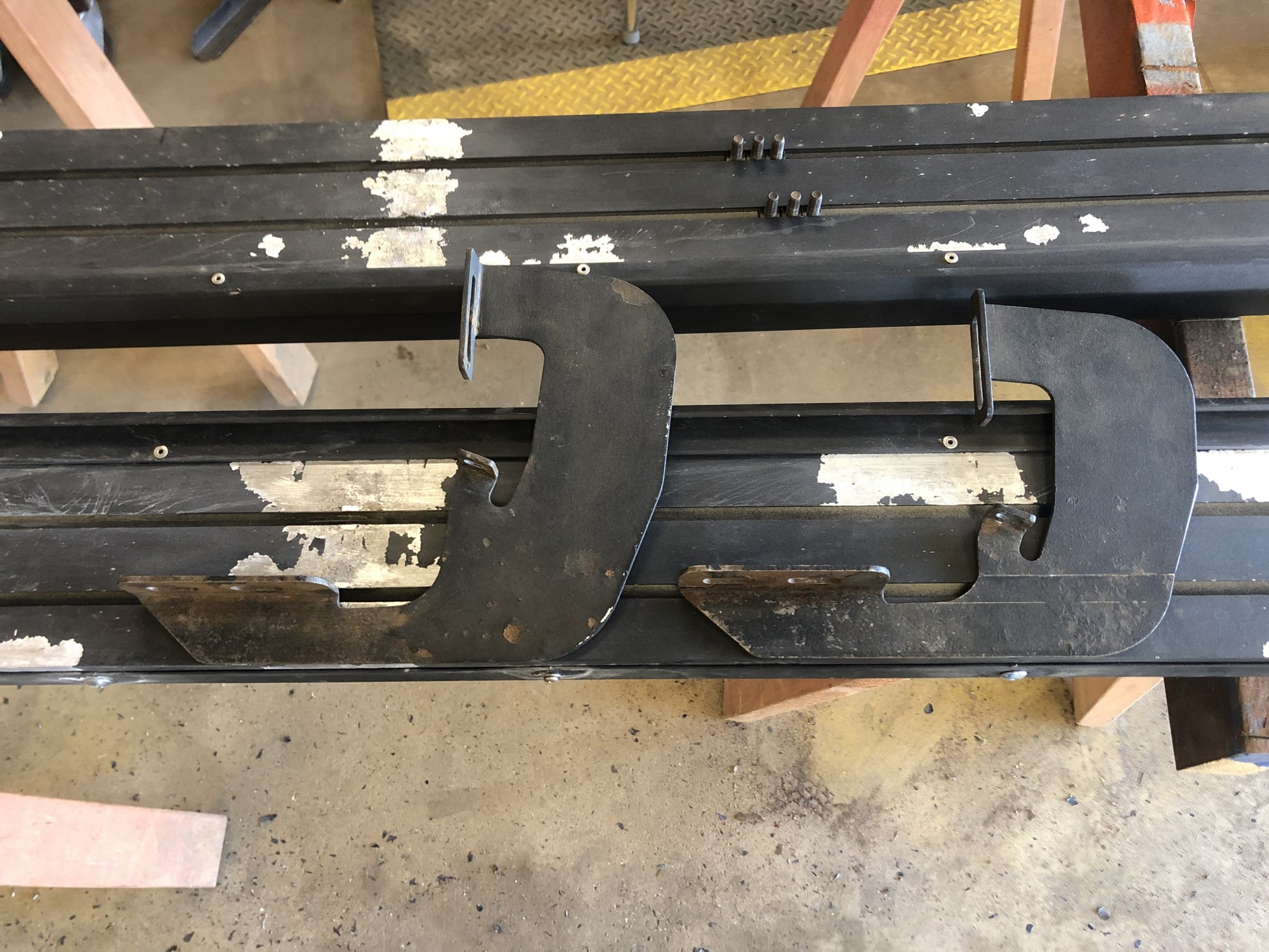

After 4 yrs of Indiana winters, the bottom of my DeeZee NXT boards are loosing their powder coat. I scraped off the loose coating, wire brushed them, and am going to spray bedliner coating on the bottom and the brackets. I’m also sectioning the brackets 1.25” to raise the boards closer to the rockers.
Tight to the rockers looks better. I also shortened the boards so they stop at the back of the cab.
