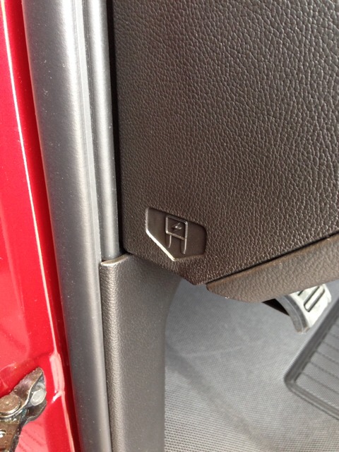

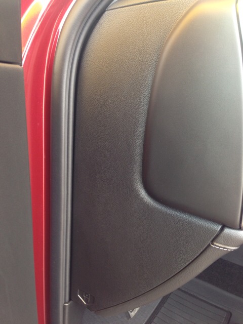

How do you go about getting that cover off?
Good damn question
Open drivers door. Panel is on end of dash. There is a pull tab on left bottom as you look at it. Should be able to pull outward from dash using this tab.
Sent from my iPad using Tapatalk HD

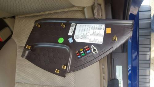

The panel cover just pops off and you need to change the positioning of the 50 amp fuse in the upper left of the photo. From my understanding if the fuse is placed closest to the front of the truck the outlets will be hot at all times. Placing the fuse in the slot towards the back of the truck gives you power with key on only. I have yet to test it but I just moved mine to have constant power.
Sent from my SAMSUNG-SM-G890A using Tapatalk
I tried that but it just turned them all off.
Sent from my SM-G920V using Tapatalk
Are you sure you pushed it in all the way. Last thing it should do is turn them off
Yes, I pushed it all the way in and in the back pins of the slot. It turned off the outlets in the center stack along with the console.
Is your ignition key turned to the "Run" position? With the fuse located where you put it ALL the outlets (both front panel and in the console) will be dead whenever the vehicle is turned off.
No, I thought by moving the 50AMP to the other slots that all my power outlets would be hot without the key.
