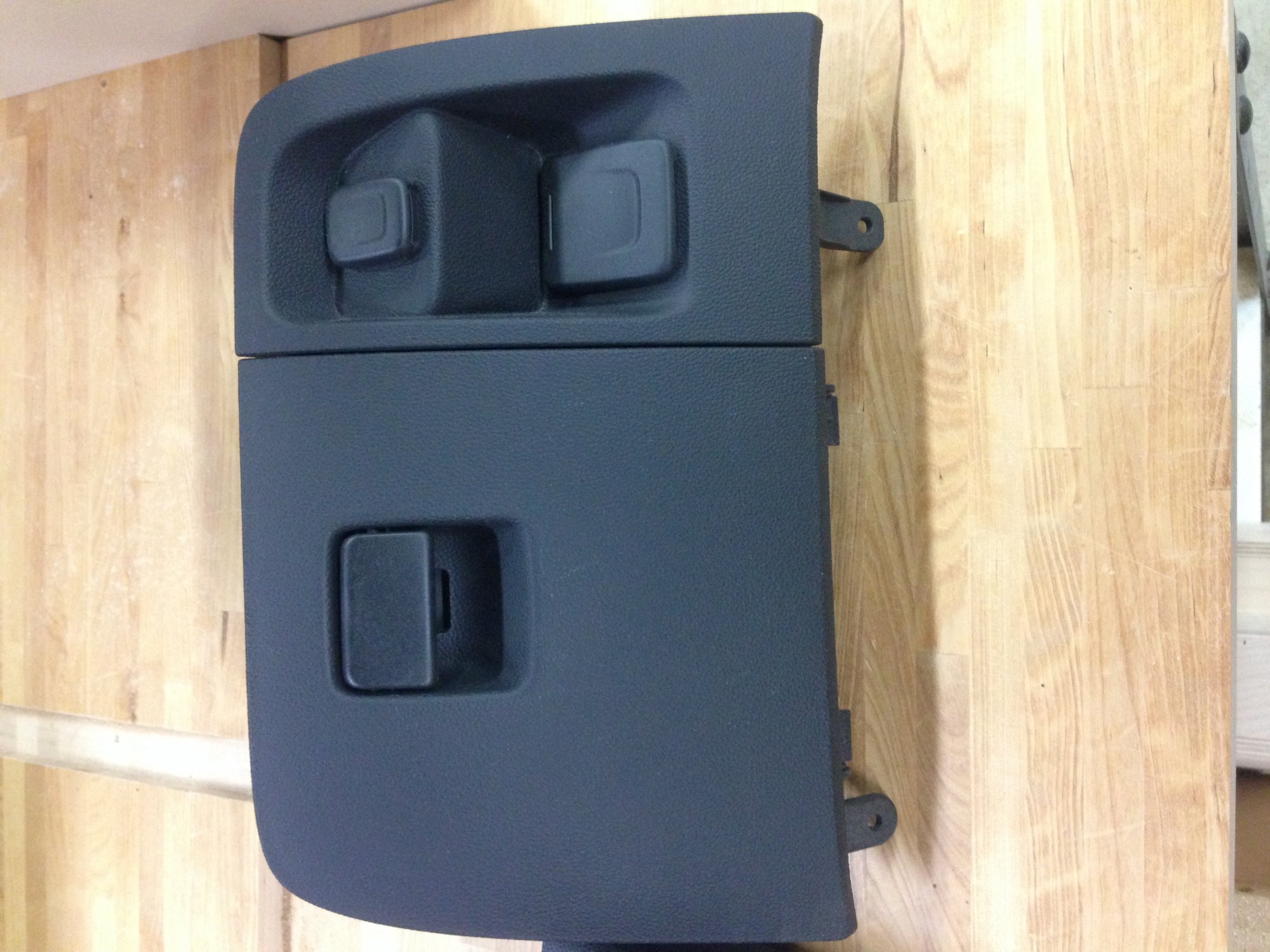

I recently traded my console to Nasty for his jump seat and  need the dash piece shown with the 110v socket if anyone who has done the swap would like to sell theirs. Also, Nasty didn't want the chrome handle I recently bought so I have that available for sale/trade if anybody is interested.

as I stated and showed in an earlier picture it only needs power & ground, I used the 12volt  cigarette plug by slicing into the wires of it in back of the console. Very simple
I got it all figured out
PM me your info.  I'll send you mine.
