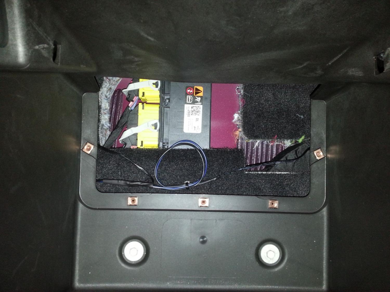

Just a quick note on the footwell lighting. I used the XGlow light pods Moto (I think), had used as I wanted to match the color of the lighting already in the truck, I basically wired them as others have. To connect to the lighting circuit, I tapped into the connector under the cover to the left of the break pedal under the dash. Rather than cut into the wires, I tinned the ends of the wires and stuck them into the connector as far as they would go. I tie wrapped the added wires to the originals so they couldn't move. I used the ground wire in the same connector as the lighting wire.
When it came to running the wires to the rear, I discovered my center console had an access panel under the rubber mat in the compartment below the padded arm rest. Removing the cover exposed a large open area that allowed easy access to the wires I ran under the console, from the front pods. I was able to easily connect to the rear lighting pods in this compartment.
I'm not sure why I have this access panel. I've seen a number of pictures posted here of the console and don't see this panel. The only thing I can think of is the truck has heated and cooled seats and the module stored in this area controls these functions? Thus the door to gain access?

I have it too. I think it is for what you said, access to some module. I actually used that to have easier access to running wires when I did my footwell lighting. I think you don't see it in most people's pictures because of the rubber mat that GM puts in the bottom of the console to cover this access panel and to protect the bottom of the console from scratches.
