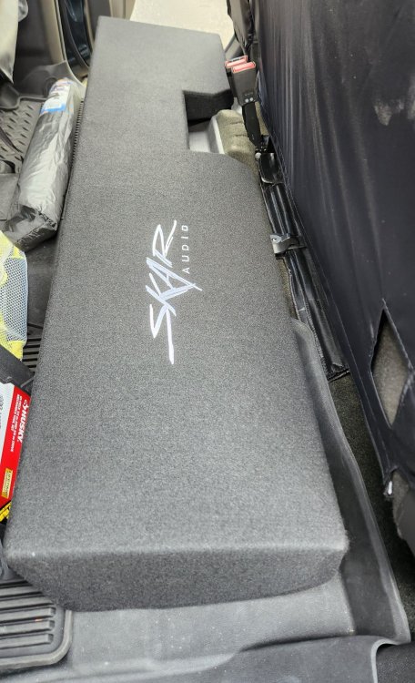

Added some 2x2" by 1/8th" wall square tubing to raise my back seats up making room for under seat speaker box. Was a tedious process with limited space for wrench inside the tubing.. 🤦‍♀️  Just clears the latches on the back so seat can fold down as well. Tubing, bolts, washer and nuts all under $60.(having a drill press and miter-saw helps) might be cheaper/convenient for the LMI kits if not.. :D

Does the back of the seat still hook in the loops on the back wall?
Yes, with the 2" height, it just clears the latches in the back to be able to fold down, once seat is unfolded, it latches(maybe a 1/2" to 1") on the back loop. I think the LMI 2.5" kit, it doesn't latch back in. 2" was just the right height for what I wanted.

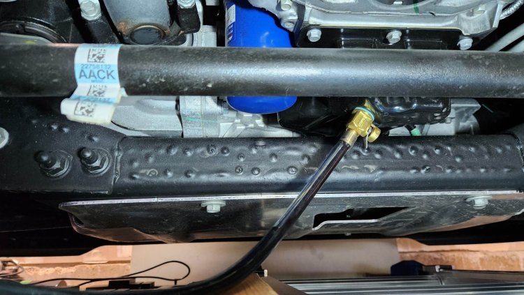

Did an oil change and rotated tires. Glad I switched to the F107N after the 1st oil change, keeps everything clean. Took a bit for relearn after the tire rotation.. passenger rear was finicky on how I had to hold the TPMS relearn tool(EL-50448).

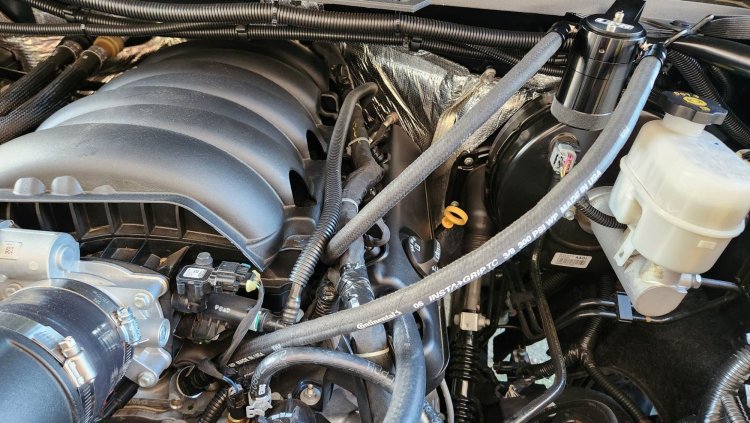

Finally jumped on the catch-can wagon, went with the UPR. With my low miles, figured it wouldn't hurt to have it. Will see how it works in the long run. Just another thing for me to remember to look at after so many mile.. :)
Up next will be to install the updated TBV. Maybe in the next week or two I'll install it, just arrived today. I had the STL010, but returned it for the GM updated TBV, only a couple $$ more.
Summer is coming so wanted to see how much it drops the temp.
