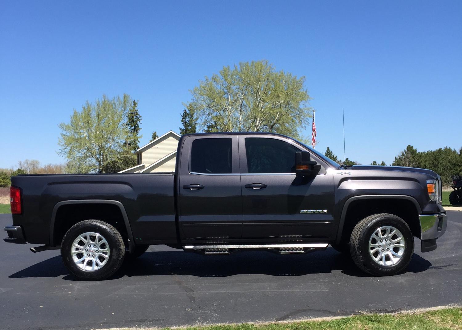

Washed and sealed my truck. Should have some new wheels and tires this week.
