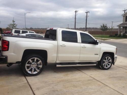

Those look fantastic :noway:
It probably wouldn't surprise you to know that the very first thing people say to me when they see my truck for the first time is "where did you get those wheels" the dealer I bought the truck from says GM should offer a truck exactly like mine with the blacked out chrome and black chrome wheels in a "SS" version right from the factory!

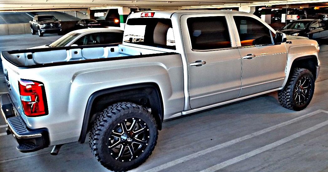

I typed it right. I have 305/50/20. I purposely wanted the shorter tire and lower profile. I'm not and expert but I think the smaller/negative offset pushed the tire out and then the radius of the tire pivot is more and then in rubs on the inner fender. I think you can go with lower then +20 but I wouldn't do that with a 305 tire because it will stick out. I'm pretty sure a 305/55 is just fine as well. The 305s for me were cheaper then the 295s and I really wanted 305. I drive aggressively and on highways so I wanted wide with low profile. I've only had the tires for a week and never had an AT tire before. I typically drive high end sports cars and SUVs and still have them. With that in mind, I love the Terra Grapplers. Definitely feel the highway and road ridges more (it will bump you offline) and its stiffer but I think it's the tire pressure. I would definitely get them again and in the same size. It just looks right and performs as intended. Here's a picture.post-136362-0-84154200-1419029586_thumb.jpg. I'd be happy to take and detailed pictures that you want.
I am running 295/55/20 Toyo MT's with 2.5 RC level kit. Wheels are Fuel Mavericks with +14 offset
