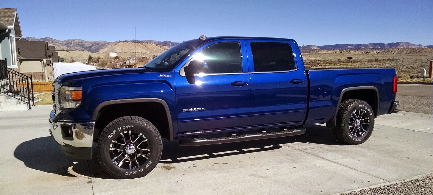

Wheels: Ultra Baron 18x9 +12 offset.
Tires: Big O Big Foot A/T 275/65R18E
2" leveling kit.
No rub but, the tires are so close to stock, that would be the case even without the leveling kit.
I forgot to mention I wanted black walls out but a few minutes with a palm sander will take the white off and avoid unnecessary remounting.
Edited by Hozer
2" leveling kit.
Man that blue is so pretty. Nice truck man.
Thanks. I still debate whether I should have gone with white so it's nice to hear from someone with a sweet looking white one.
