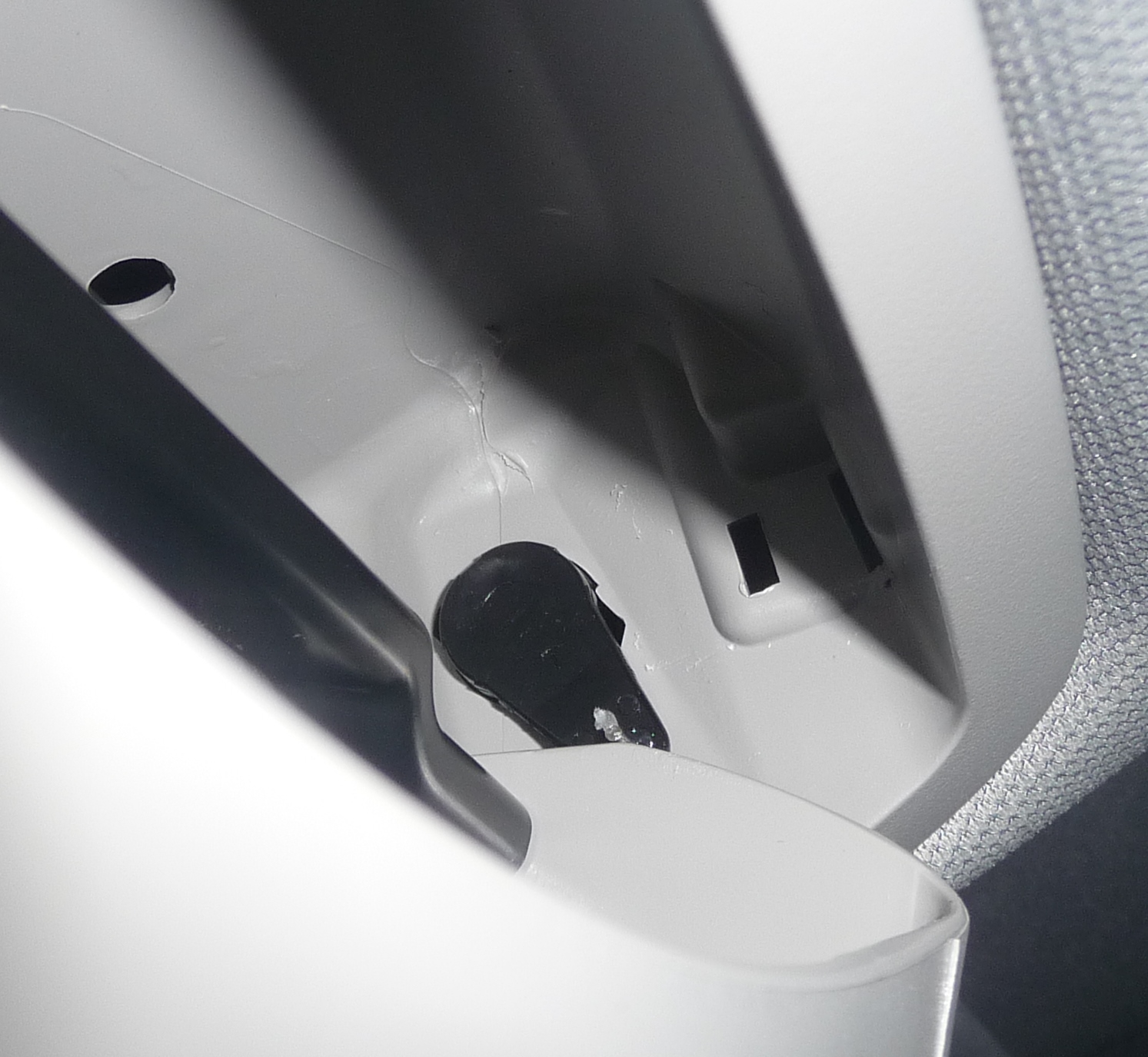

So you ripped out just the one that moves or the entire clip? Did you break it off or did that one middle peice separate from the rest? Thanks.
the whole thing comes out. Leave the other one there that's next to it. The sunglasses door still stays closed without that clip. See attached pic.
Thanks Stevev! Did you just pull it out with grabbing it or with pliers? Is there a certain way it comes out? Just don't want to break anything taking it out. Thanks for the help.
maybe try a flat head screwdriver to help pry it out of there, but I just recall yanking it out of there and it didn't break anything else.
Does anyone know what the original purpose of that rattle switch was? I tried to pull mine out too and it just bent so I quit pulling. Seems to have helped.
I'm loving the fact that everyone is ripping this piece out and it has absolutely nothing to do with the sun glass door staying opened or closed....WTF!!?
I'll be ripping mine out this week I Just amazed it doesn't seem to serve a purpose!?
I tell you what , that thing was dirving me insane.
For 2 months , I was almost going mad trying to figure it out . I was never ever to pin pioint the noise to the sunglass holder , I always thought it was pass door.
It was like the heavens gate opened when I saw the older thread about this little clip .. F that clip!
You couldn't have said it better. I thought it was the passenger door too. I was trying to feel and push everything on the passenger side to see it that was the rattle. I also was happy to see this thread. F that clip!!!
F that clip is right! I located it in my truck and ripped it out with some needle nosed pliers. I was a little apprehensive at first but went thru with it. Since its been out, its been a lot quiter. Its amazing how that rattle really makes you think its something in the passenger side
